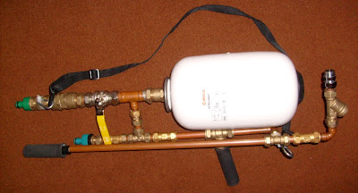

Hey guys! Our high school has an annual water wars with a $2,000 grand prize. It is for seniors only and our team wants to go out with a bang.
We have never made our own guns, but got some money together this Thursday and got to work. What we have now are two basic APH guns, following the instructions from an old sscentral article.
Here are a couple of pictures =]
http://i.imgur.com/ZlOuVh.jpg
http://i.imgur.com/B713Sh.jpg
http://imgur.com/a/6szxB#FX3NJ
At the moment we are tweaking the guns for more power and easier pumping. The pumps we have are very poorly made because it was out first time. The guns start leaking only after a couple pumps and we need to fix that.
We had the idea of getting an air tank and hooking it up instead of the hand pump. Would something like this be possible?
We have a huge hiking backpack with two 5 Gallon bags of water in it. We are both big guys and would easily be able to run around with a big tank connected by hose to the gun.
Has anything like this ever been done before? Is it even possible? If so please help us out, we have lots of stores with everything available and easily accessible. We need to finish these bad boys off soon.
If you have any other recommendations on how to improve our guns, or alternative pumping methods, please do not hesitate to help us out.

Hooking up an air pump wouldn't work since you're pumping water. Just try making more pumps using different methods. Try giving them multiple O rings. Also, to make sure the pump stays centered, did you put an end cap on the end of the pump tube?

You might want to try using a pair of skirt seals rather than O-rings. They are found in the same place as you'd find O-rings. The best way to attach them is up to experimentation. I'd imagine that one could drill a hole through them and into the rod, and hold it in place with a long screw and epoxy putty. Alternatively, you could find some cheap stock soakers and saw their pumps off for the homemades. Those ones won't leak as long as you attach them with something that can deal with being under water pressure, like epoxy.
An air pump will not replace the need for a water pump in a homemade using a separate pressure chamber. Water is moved from the reservoir into the PC using suction. Solar showers work pretty well for backpack reservoirs. They are cheap and easy to attach. I would also recommend adding torque arms to your PVC ball valves - they will open much faster and easier that way.

Alright, so using a pump would do nothing, damn we're so lazy haha. On our bigger gun of the 2 we added a cap and handle to the pump, is it expected for water to start leaking at some point no matter how well we put the pump together? When I go to Lowe's tomorrow I'll check out the skirts. We are using the solar showers, that's what I meant when I said bags of water. Are there no options for automating the pump?
Also, we after looking over the FAQ's on the other archived website, I still couldn't find information on how long the gun is supposed to fire? And also, I read about prepumping, but it seems to do nothing in our situation, what could be the reason behind that?
One last question. We have a good bit of money and supplies left over from these two guns, is there a different style weapon that would be versatile for street warfare? Our competition spans the entire city with very urban areas. In addition we have a protected forest where tie-breakers will be held. What other types of guns, home-made or otherwise, would it be a good idea to have?

Put a cap on all of them. It'll help the seal since the pump won't be wiggling around. A pump will eventually leak; this should happen when the O ring (or skirt seal) wears out. The amount of time that the gun fires depends on how big the pressure chambers are. This tool is supposed to be able to calculate it.
For an automated pump, I have made several designs involving hose pressurization. Basically, you forget the bottom half of the APH so that there's just a check valve connected to the pressure chamber(s) and the firing valve. You press the hose into the check valve (a length of PVC is attached to the hose), and the gun fills up and pressurizes it. Thus, no pumping is required. The 2L Homemade (shown on SS Central) is a cheap example of this, but most of my designs were built from PVC pipe.
How much money do you have left? I would recommend getting some powerful air pressure Water Warriors blasters, most notably the Colossus and Gorgon. The Colossus has a nice shape, has decent power, and has a huge pressure chamber. The Gorgon is very powerful, but can be difficult to pump due to its weird pump shape.
If you have a LOT of money (a few hundred dollars), you could buy some vintage CPS blasters. Anything that says CPS on it is pretty powerful and useful. You can find some CPS guns for sale on eBay.

Thank you so much, we will head out to the store tomorrow and grab a few Colossus's, and we have enough left over parts to make a hose pressurized APH too!
For our current guns though, when you say get caps, do you mean putting a cap on where the pump goes in and then drilling a hole big enough for the rod to go through?
In addition, for the front we currently have some barbs that I think are 1/4" ID, is that too big, and would there be any better type of nozzle?

Just as an update to what we have going on, today we bought two pesticide tanks with a pump built in, this allows us to prepump our guns with water, and then continue to pump with the onboard pump. The only problem is we have 2 Gallon jugs, and they are not big enough, we have some hiking backpacks that can fit the biggest one they have at Lowe's so tomorrow we will go get those instead. We keep having our O-rings snap on our pumps and it's really frustrating. We are looking into what we can do to make a better pump. Our large gun fires 47' tops, and we haven't tried the smaller one with backpack pump thing.
Thank you for recommending those Colossus guns, they are pretty solid and are a good sidearm to our big ones. In addition to those, we have 400 filled water balloons and if we can figure out how to make our power washer less dangerous, we will be mounting it on our friends pickup truck for super awesomeness. We have a few mountable cameras that we plan on having record our battles, mostly because it's cool to watch but also if someone ends up cheating, after all it is a huge cash prize.
One more thing, would it be wise to add something like this to our arsenal? http://www.sscentral.org/homemade/supercps.html
I just skimmed the instructions but it doesn't seem to difficult to make, would something like that be ideal for our type of water war?
I know i'm asking a ton of questions but this is just my first time doing anything like this and we really want to win. Thanks again for being so awesome and welcoming, I have found building these guns very enjoyable and regret that I didn't try it sooner!

A Water Balloon Launcher could be useful. Search for it, there are some recent threads that contain a lot of information about the subject.
The SuperCPS has simalar performance to the APH, but can fire strait up or upside down, which the APH cannot do. It could be useful if somebody is attacking you from an upstairs window.

Would something like this work? http://www.sscentral.org/homemade/havoc.html

That's a pretty good design. To reduce the price, you may want to make the shape linear instead of over-under.

We ended up building it just like in the article, but had to improvise the actual valve to pump it up by just cutting one off an old bike tire. I'll post some pics later tomorrow.
Re: Our New Guns! We need some help with ideas

I know it's probably a little late but a quick fill hose system, as martianshark mentioned earlier, would definately make pumping easier. You can quite easily add a quick fill system to your current aph's so you can pressurise them in a few seconds from a hose, or by using the hand pump if a hose is not available at that time.
All you need is another check valve a t-junction (to replace the elbow, or to fit between ebow and PC) a 1/2" or 3/4" threaded connector and a suitable hose connector (similar to the blue/green connectors on the end of my blaster below (The top one is a nozzle, the other is a quick fill device). This quick fill adaptor MUST be fitted past the second check valve (see diagram, the quick fill bit is the red area) otherwise you'll end up firing out your pump rod!
The pics you linked to suggest there isn't much space, so you could always just add one of those hose connectors (aka tap connector) to the front of the blaster (as a nozzle like the green connector in the pic) and use that to pressurise the blaster, aswell as the hand pump, by opening and closing the firing ball valve with a hose connected. That would mean you don't need to heavily modify the existing designs.
Anyway, good luck with the water war!

It might also be easier to just have the hose attachment go in the smae place as the backpack connects.
As long as you hold on tight! I tried this once (using the silver backpack connector on the buttstock) before fitting a quick fill device.
It can be done, but if you do put the hose connector where the backpack connects to the blaster, the pressure will force the pump forwards, and even out of the blaster. Also, unless the pump has a really good seal, it will leak quite a bit when pressurising. Yes you'll pressurise the PC a lot quicker than by pumping, but you'll still have to put a lot of effort into holding the pump in.
Oh yeah…
I suppose you could drill a small hole through the pump handle and tube right at the end and put a long nail through it to hold the pump in.
