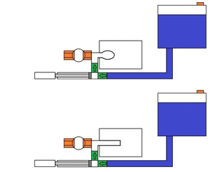

CPH Firing Steps (Top:Spherical PC, Bottom:Cylindrical PC)
The basic Elastic Pressure Homemade operates on the principle of the elastic expansion of rubber. During the first stage, the reservoir is filled with water at room temperature and pressure. During the second stage, water is drawn into the pump through the first check valve. During the third stage, the pump is retracted, forcing water through the second check valve and into the rubber chamber. As water is pumped into the rubber chamber, it expands, and the rubber applies pressure inwards onto the water. Due to the nature of rubber expansion, the pressure remains constant, as long as ther is water in the chamber. In theory this means that a single pump worth of water in the pressure chamber will reach the same distance, when fired, as a full pressure chamber, although the shot will be substantially shorter. This is not always the case, however, as there tends to be a slight drop in pressure when the bladder is almost empty. Also if the nozzle is too large, then there will not be enough water to maintain the stream over the full distance. During the fourth stage, the outlet is opened and the rubber chamber forces the water out of the nozzle.
