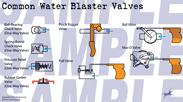

Started working on drawing various valves found in stock water blasters.
Based on the above sample image, are there any valve types that should be added?
What I plan to do is to provide more information on how each of these valves operate and give a sense of how water flow is affected in a general sense. No current idea on how long it will take both to create all the illustrations and create the accompanying write-up. As there are a good number of valve types to discuss, I may end up creating a base article first, then add in more images and information as time permits.
As an aside, the Max-D valve was rather difficult to draw well and it'll be even more "fun" trying to illustrate how it actually functions. :goofy:

Animated Max-D diagram (complete with a simulation of the noises they make), go! =p
Anyway, the pull valve diagram is a bit lacking in disambiguation and detail. How does the pin seal from the back? The sealing piston on the front should cover up the hole entirely. The rest of the valves look pretty good.

CA99 wrote:Anyway, the pull valve diagram is a bit lacking in disambiguation and detail. How does the pin seal from the back? The sealing piston on the front should cover up the hole entirely. The rest of the valves look pretty good.
The plug on the front of the piston closes the hole (no gaps), but I illustrated some tubing in front where the rectangular bump is. As for the rear-side seal, I now realize I'm missing an internal spring and can add a little more detail for the gasket around the pin. Thanks for pointing that out!

Glad you like the diagrams, but while I might be able to export the Illustrator art for something compatible for CAD programs, since these are only 2D and not really to scale, their usefulness would be somewhat limited.

Not only are they 2D, I highly doubt that iSoaker tried to dimension any part of them accurately lol.

For what it's worth, the triggers are actually to scale, but the rest of the valve parts are not. :goofy:

Well then, you are at least partially forgiven. In all seriousness though, these will be great for instructional purposes. In the future we'll be able to use 3D scanners to put different parts into CAD. There's still so much about stock internals that we have yet to learn. In theory you should be able to make predictions about pump volume, flow and other factors based on the size of the parts used.

OK, so first off... what water gun uses a ball bearing valve?
Second, your pull valve diagram is wrong. The spring goes after the hinge on the rod.
Here's an overly detailed crappy drawing that I whipped up in a few minutes: (with the valve open)
Or something like that. *EDIT* Yes, this is a Super Soaker CPS style pull valve.

@soakinader: Nice sketch! You're right; I had the spring on the wrong side and omitted the internal spring. I've created an improved illustration already based on CA99's comments above, but your sketch covers it well.
As for the ball-bearing valve, most small squirt guns (think Water Warriors Kwik Grip XLs) use them since they are cheap and easy to make. Not the best of valves, particularly once tubing inner diameter passes a certain size, but for small trigger-based blasters, they're perfect.
Edit: pull valves on the newer Water Warriors water blasters don't have a spring on the back side of the pin.
