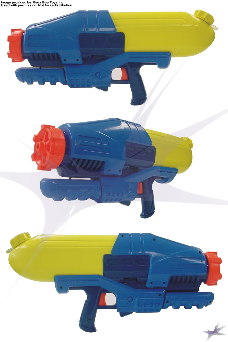

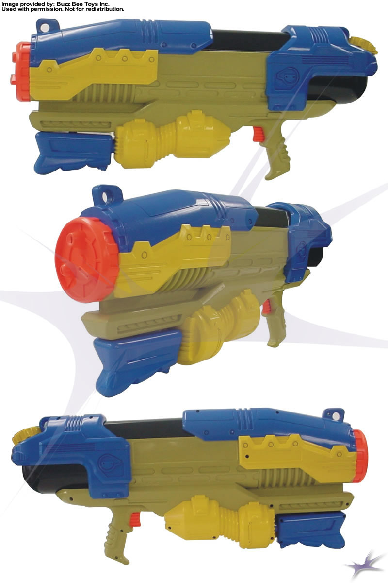

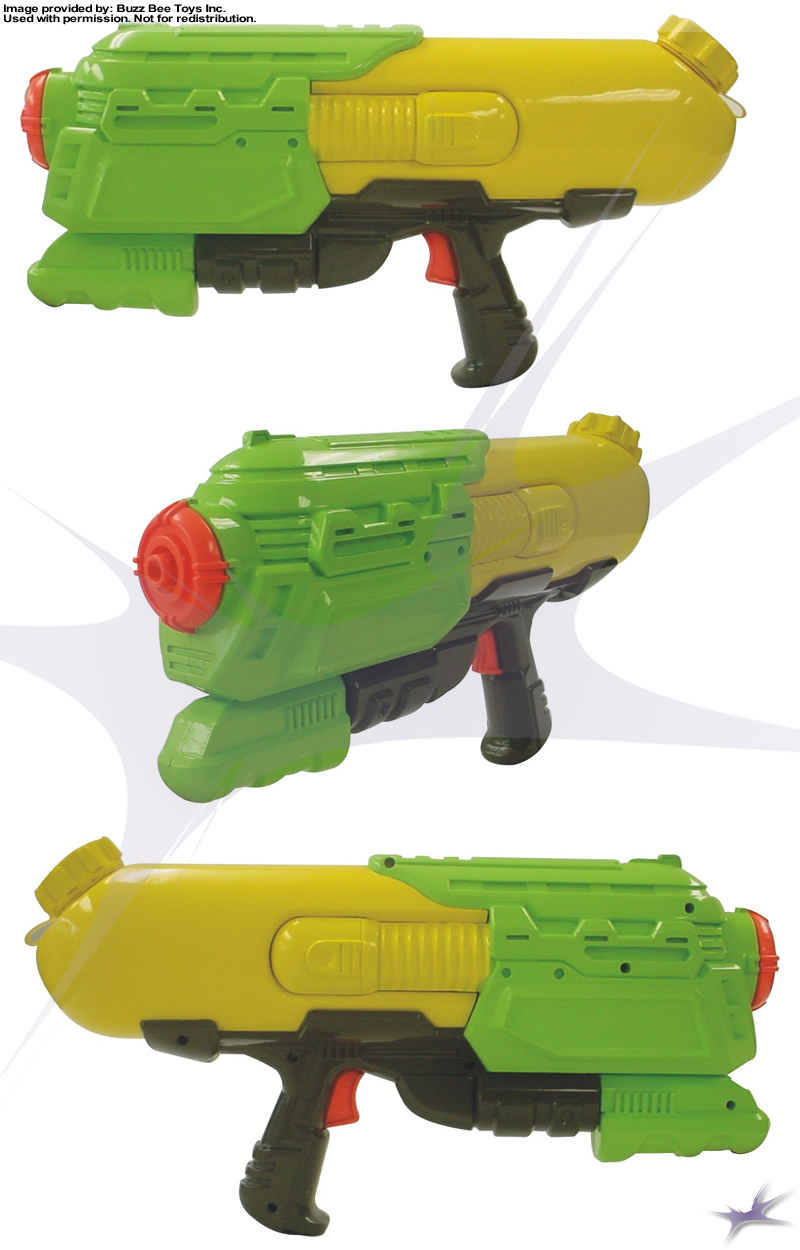

The following images are some stock photos of the new Water Warriors Pulse Series. I really like the looks/styling of this series. If Fox's report of the blasters' performance is true for the rest of the line, the upcoming 2009 season looks like it'll be a great one! Of course, I also await to hear more reports from "Down-Under" about how these blasters perform in the field.
The Water Warriors Pulse Blaster
The Water Warriors Pulse Strike
The Water Warriors Pulse Master

BTW, notice anything funny about these pics (apart from the lack of stickers)?

How do you mean funny? The pistol grips look TINY. I'd be afraid of snapping them off.
Love the look of them, color, styling, size, everything. BuzzBee really did some good work here. I'll be interested in hearing how they perform.
They're wooden models, right? :D
They look awesome, I'm really hoping that I can find the other 2 guns somewhere.
I hope I haven't overhyped the gun's performance though! Again, shot time is very short and the pump lags making pressurizing slower than it could be. In that respect it's about on par with the Xenon, so if you didn't like the Xenon then this gun isn't for you. However in every other respect (build quality, looks, capacity, ergonomics etc) it's a lot better than before.
I agree with Adrian in that the grip on the PulseMaster look too small and fragile, however the plastic they're using (at least on the PulseStrike) seems tougher than previous years so it shouldn't be a problem.
