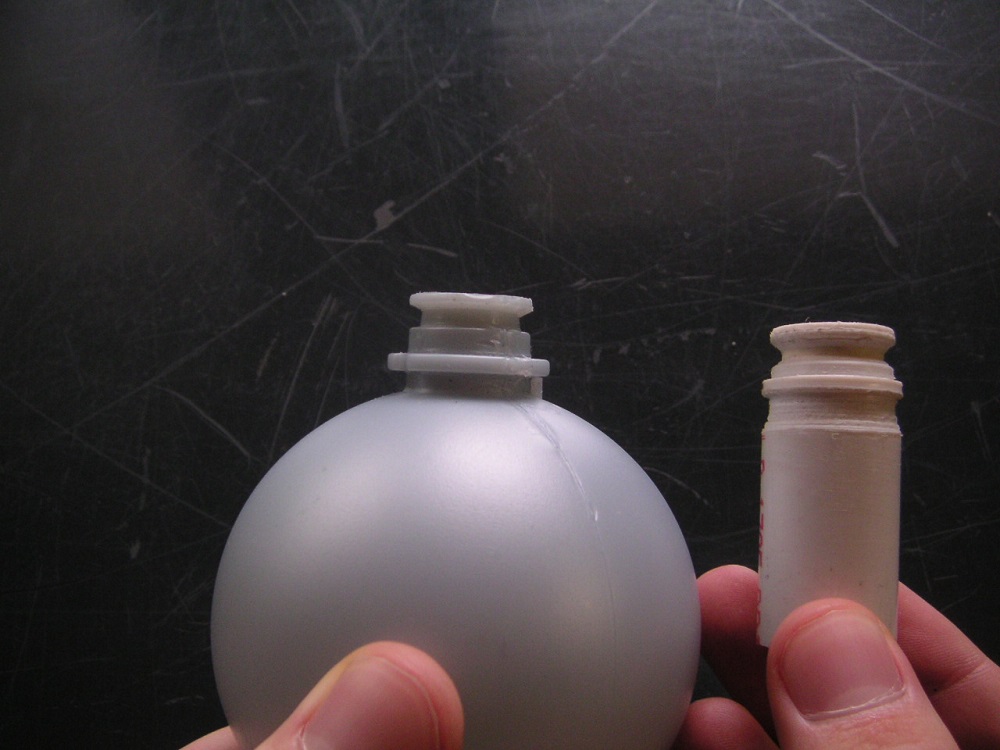

Well here's what I did to attach 1L bottles to my MD 6000.
I used a lathe to carve a piece of PVC into the same shape as the PC attachment/adapter/whatever the fudge it's called, then I cemented the bottle around the pipe (because 1/2" PVC happens to fit perfectly into the mouths of the bottles I used). For extra reinforcement, I used a hose clamp to hold it down.
Here's the best picture I have.
Sorry about the size; I have no idea why the pictures don't resize themselves to fit the screen...
Of course, that method is quite a bit harder, and you need to have a lathe. The good thing is, it's completely reversible. I can put the old PCs back in there whenever I want (I just have to transfer the O-rings).

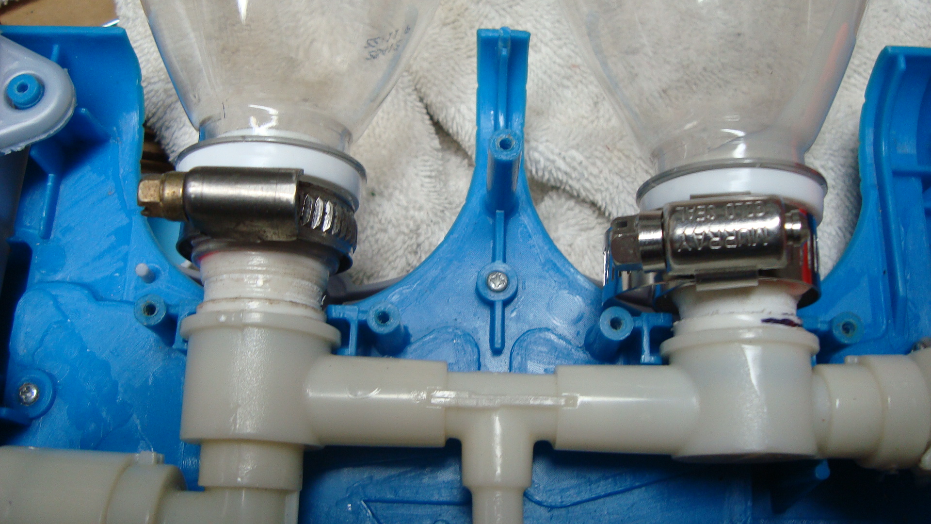

Post by TheSoaker » Wed May 22, 2013 8:59 pm
ok im done. heres what i did: i just used pvc cement to glue the new pc in place and for the nozzle I just cut off one of the nozzle selectors from the Y and attached it to the pipe that goes from the valve. i have not done range testing yet because its way too windy outside Image Image Image

Dude, that is absolutely sick. I have just one suggestion, take several grades of sandpaper and wrap them around a pencil or a rat tail rasp (even better) and smooth those custom nozzles out. I'd start out with 100 and then give it a good sanding, then follow up with 180, 280, 500, P800, and then if you're really crazy seal it all off with P2000. This will give you a stock level smooth stream. I'm crazy about sanding things out to get a good smooth nozzle (unless I'm going for a riot blast).
Re: XXP 275 PC expansion
Post by soakinader » Fri May 24, 2013 2:01 pm
Hmm. I'd like to see how the performance has improved. I think you went a little crazy on drilling out the fan and shower blast; it looks like you now have 1X,3X 10X and 12X. Maybe you should experiment with some epoxy putty and/or a straw on the second XXP nozzle (you can just unscrew and swap them) and try to get an effective intermediate setting. Chances are this gun can support 5-8X pretty well.
