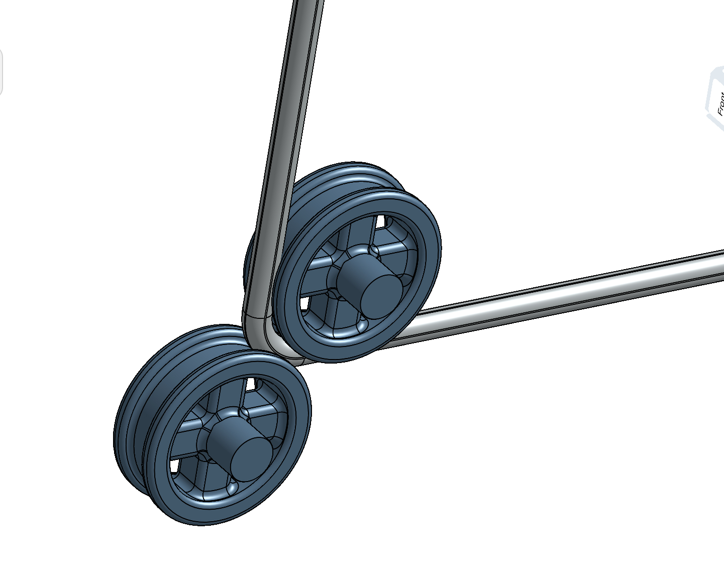

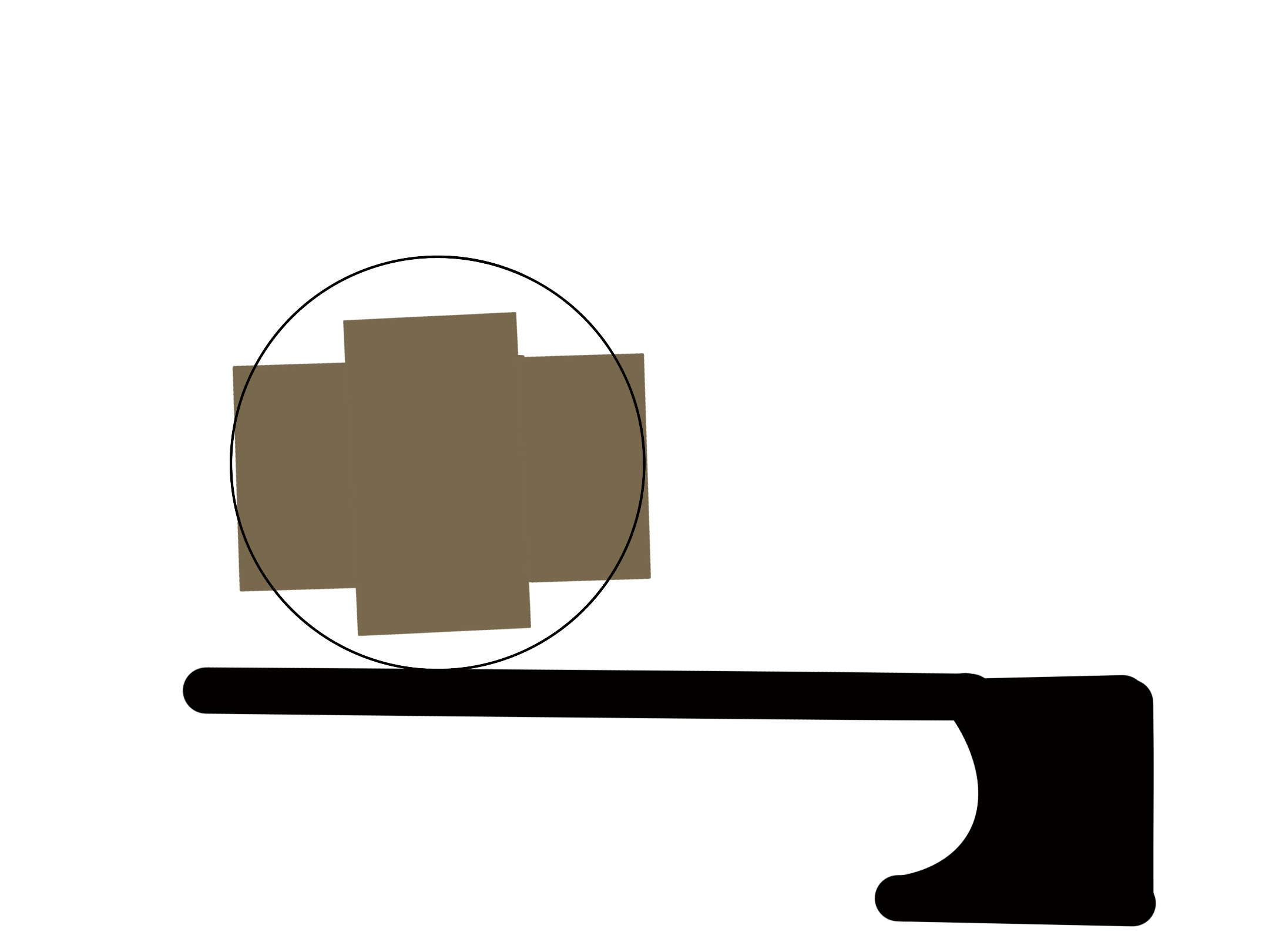

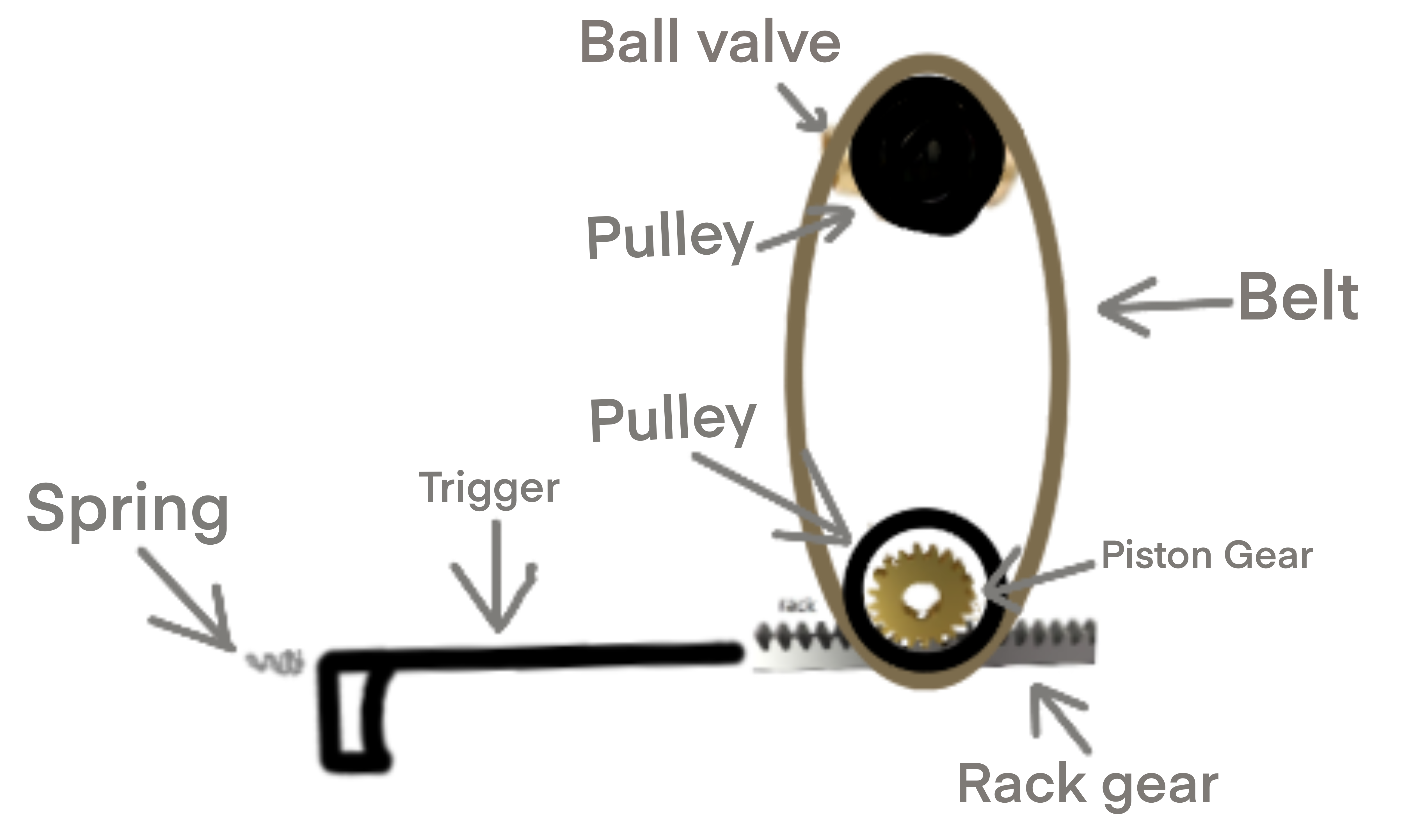

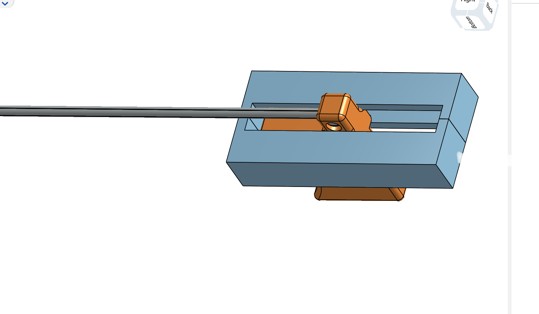

I was thinking that if you had a ball valve by save a lever it’s a gear and you just have when you pull the trigger back it’s turning to gear kind of like this
would have to figure out somebody to reset it but it could work and you could either do it with something like 3-D printing with a good material Trish idea any thoughts
Edit : This is what the gear system should look like
A Janky soaker is the best kind of a soaker
Re: Crazy trigger valve idea
Post by SSCBen » Fri May 20, 2022 10:46 pm
Welcome to WWN!
This sort of setup is not crazy at all. It's called a "rack and pinion": https://en.wikipedia.org/wiki/Rack_and_pinion
You can buy them on McMaster-Carr: https://www.mcmaster.com/gear-racks/
I don't think it has been used for water guns, but it should work. The trigger pull might be too long if the ball valve is too large, and you definitely want an easy-to-open ball valve for this sort of design.
Returning the valve shouldn't be that hard with a spring.
Post by Drenchenator » Sat May 21, 2022 10:00 am
This is a pretty interesting idea. As Ben said, though, the issue becomes the tradeoff between how long of a trigger pull you want versus how much trigger weight you want. My experience is that some ball values are quite difficult to open (they require a lot of torque), so you would want a larger gear for more mechanical advantage. That however, would result in a long trigger pull. I used lever arms for the trigger in my designs to avoid this issue, since the trigger only then has to rotate and not move linearly. That said, this is a pretty cool idea that I would love to see implemented in practice.

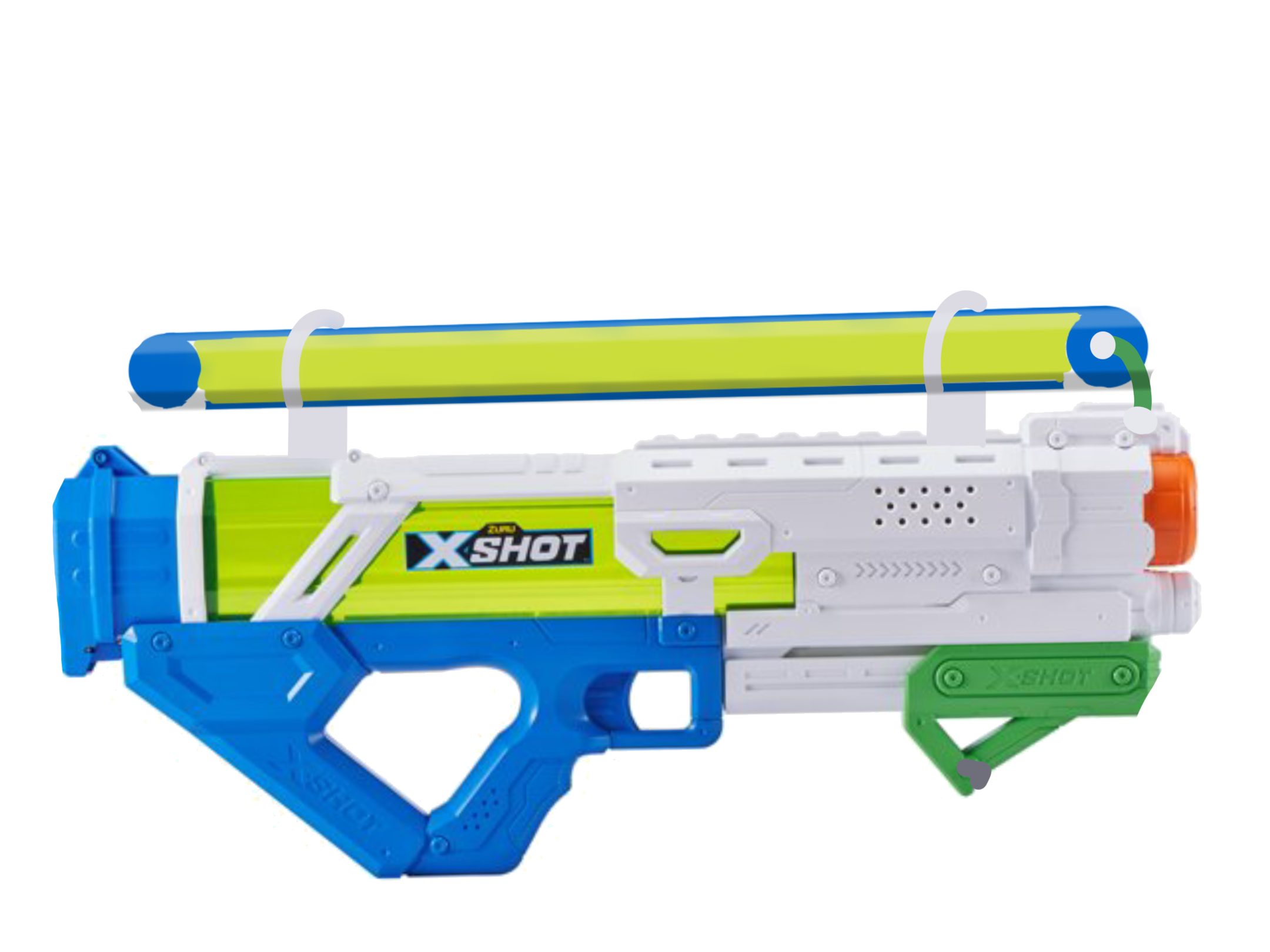

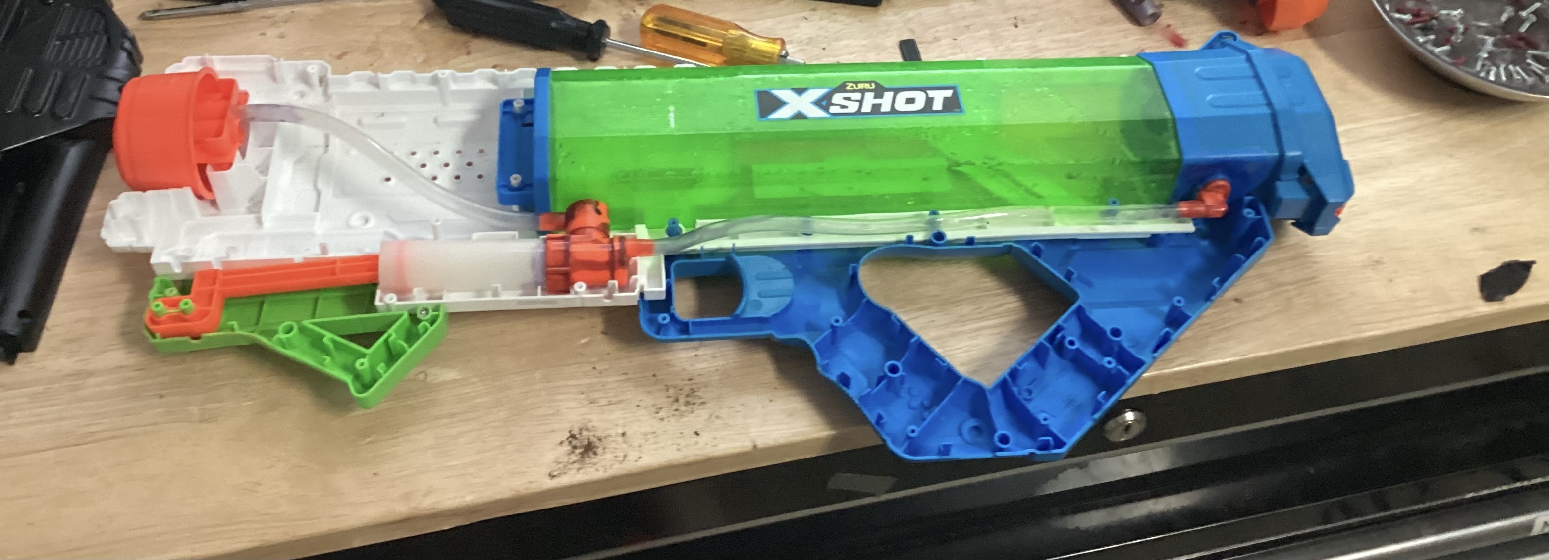

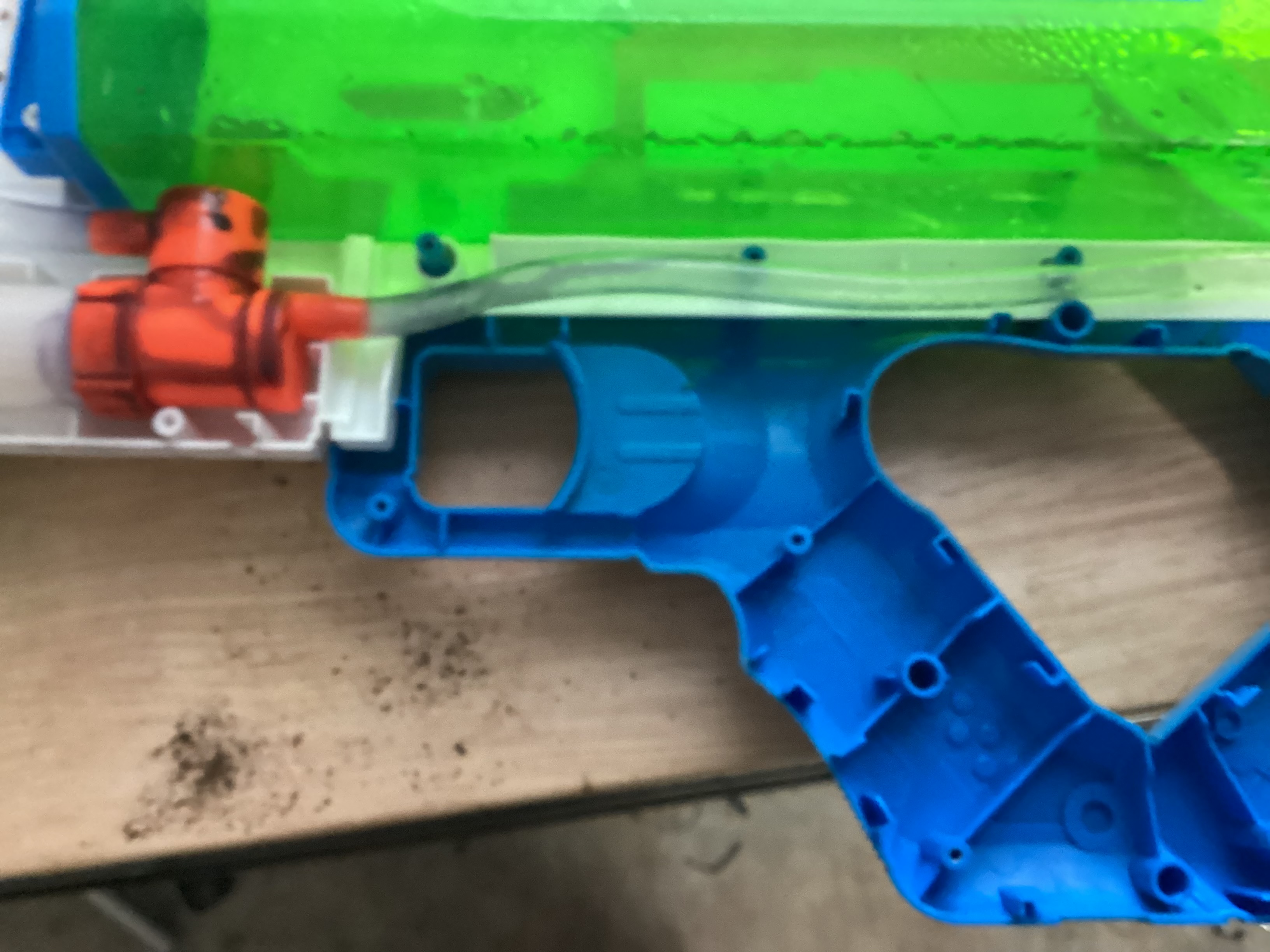

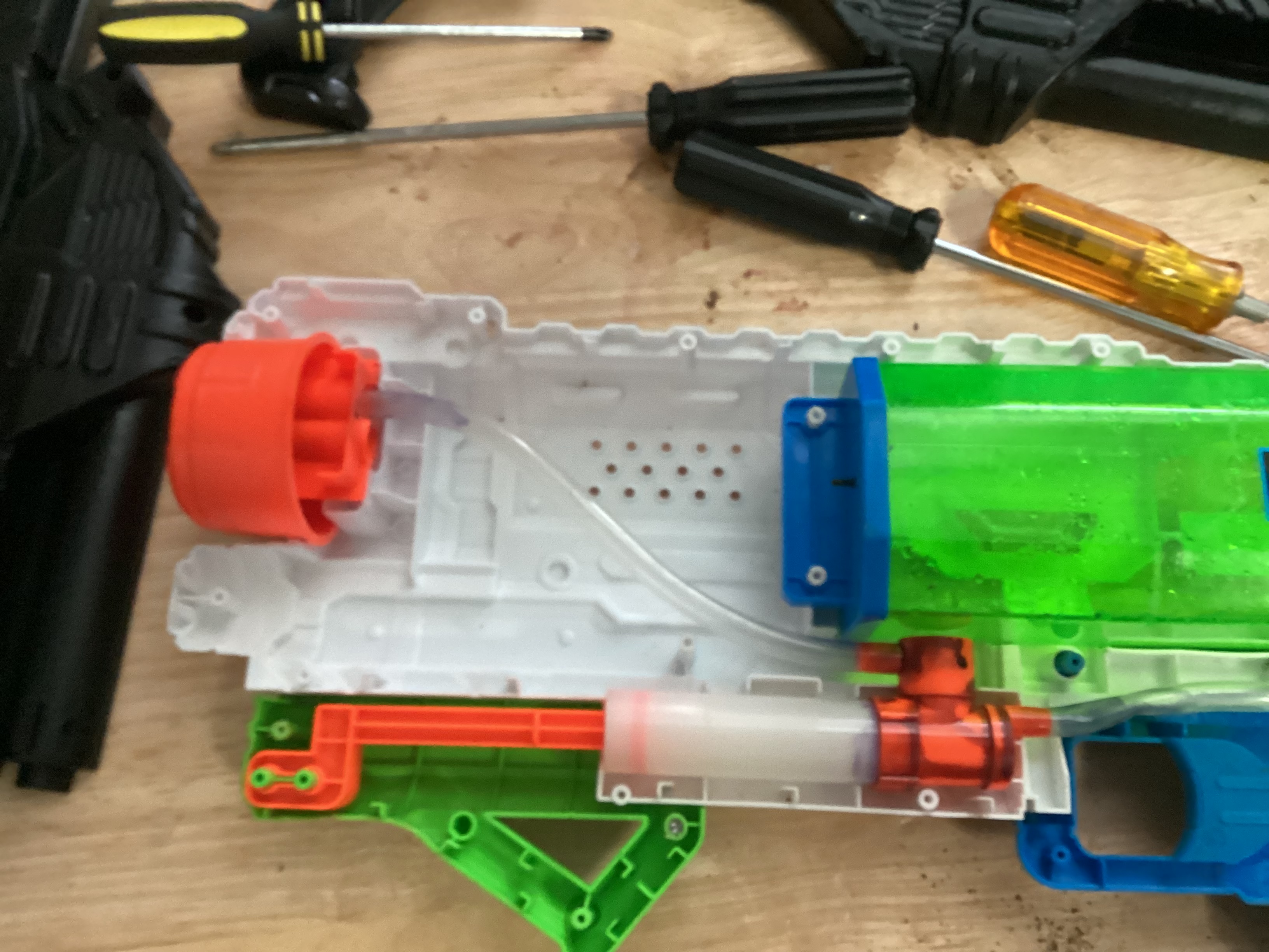

It will have to work with the trigger on this gun
I’m trying to convert it to a pressurize reserve I really love the design of it so I have the case I think this piston and rack trigger mythic would be really good for people to turn pump action water guns in to pressurize reserve once
Edit : this is what I came up with
any thoughts
Post by SSCBen » Mon May 23, 2022 11:05 am
Converting pump action water guns to separate pressure chamber is possible, but you probably won't be happy with the result. I actually did such an upgrade with a Super Soaker Vaporizer over a decade ago. It didn't use a real trigger, though, just a ball valve. I used the piston as a pump, which didn't work that well because it was too wide for a separate pressure chamber blaster, which made pumping hard. I could have completely replaced the piston chamber with a better sized pump, but it would be difficult to get the pump to fit well with the existing design. The case also did not have enough space for the pressure chamber, so the pressure chamber was external to the blaster. I don't see space for a pressure chamber on the XShot. Similarly, if the XShot doesn't have the internal space for a functioning trigger, it's going to be really difficult to modify it to have a functioning trigger.
It would be easier to build a completely homemade water gun with the design you want than to convert an existing blaster that is too far away from what you want. As I wrote in the SSC FAQ over a decade ago, "you can't upgrade a tricycle to perform like a monster truck".
Post by SSCBen » Mon May 23, 2022 12:49 pm
A pressurized reservoir would be dangerous here. The existing reservoir is not designed to hold pressure and could explode if pressurized. Do not pressurize the reservoir.
The internals are more spacious than I anticipated, and the pump does not seem particularly wide, so this may be a better candidate for a separate pressure chamber. You might find extending the pressure chamber out the top of the blaster to be good to get more water volume. Getting a working trigger looks like it's going to be difficult, however.

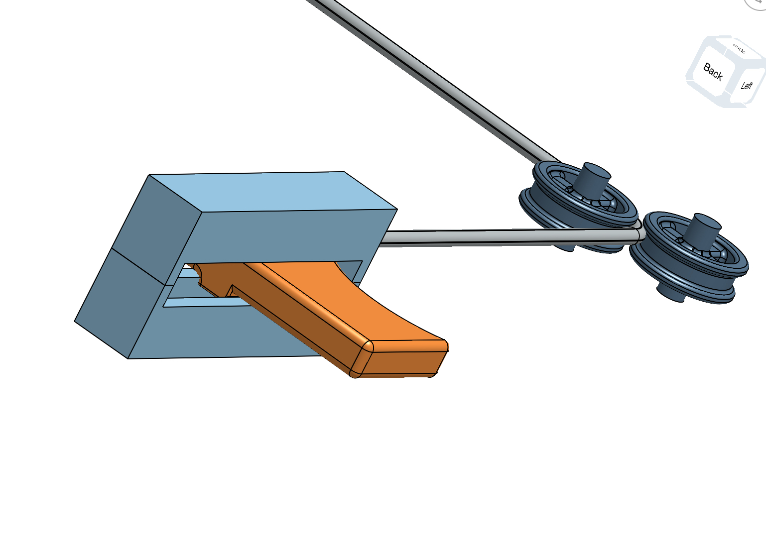

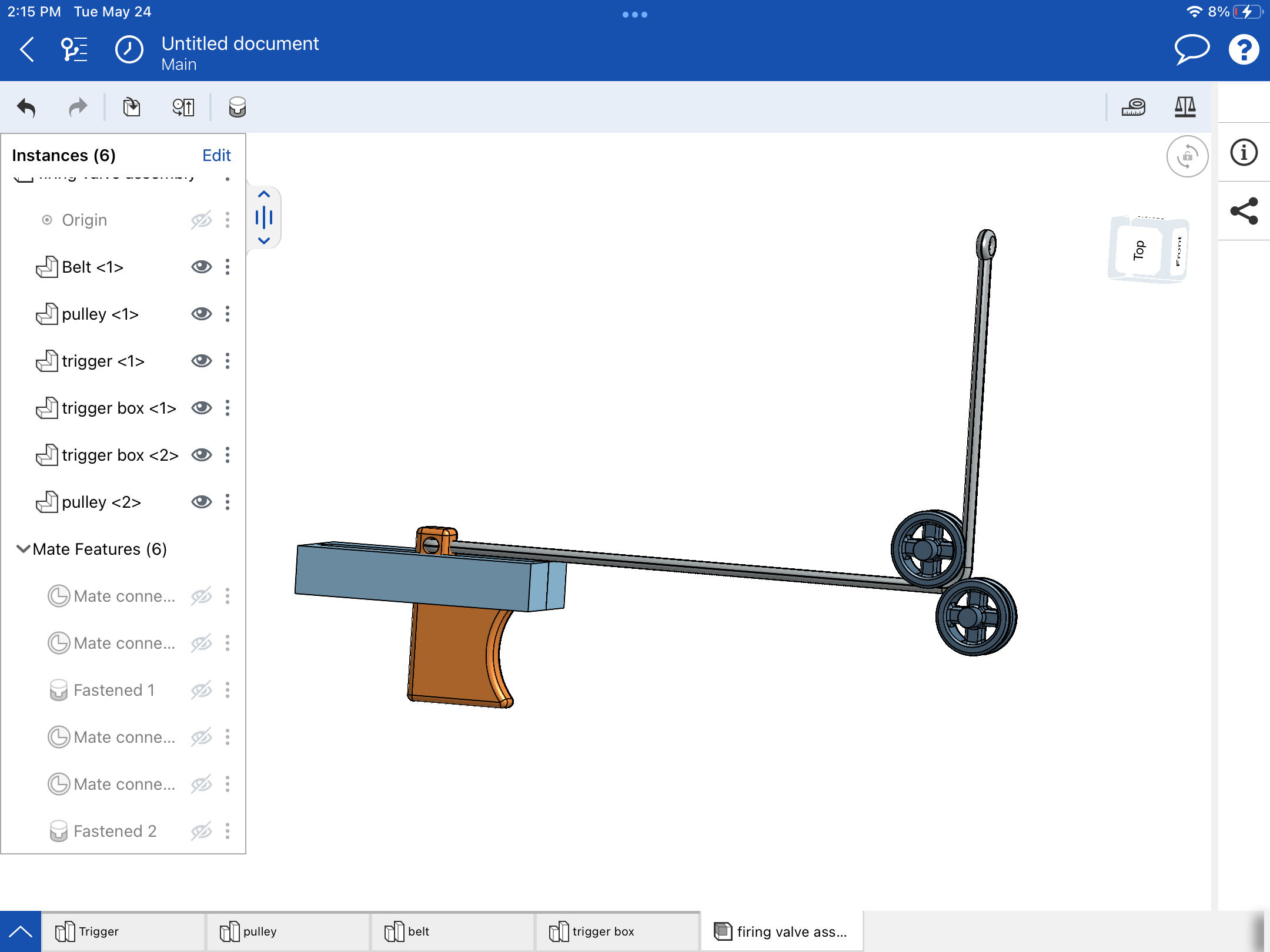

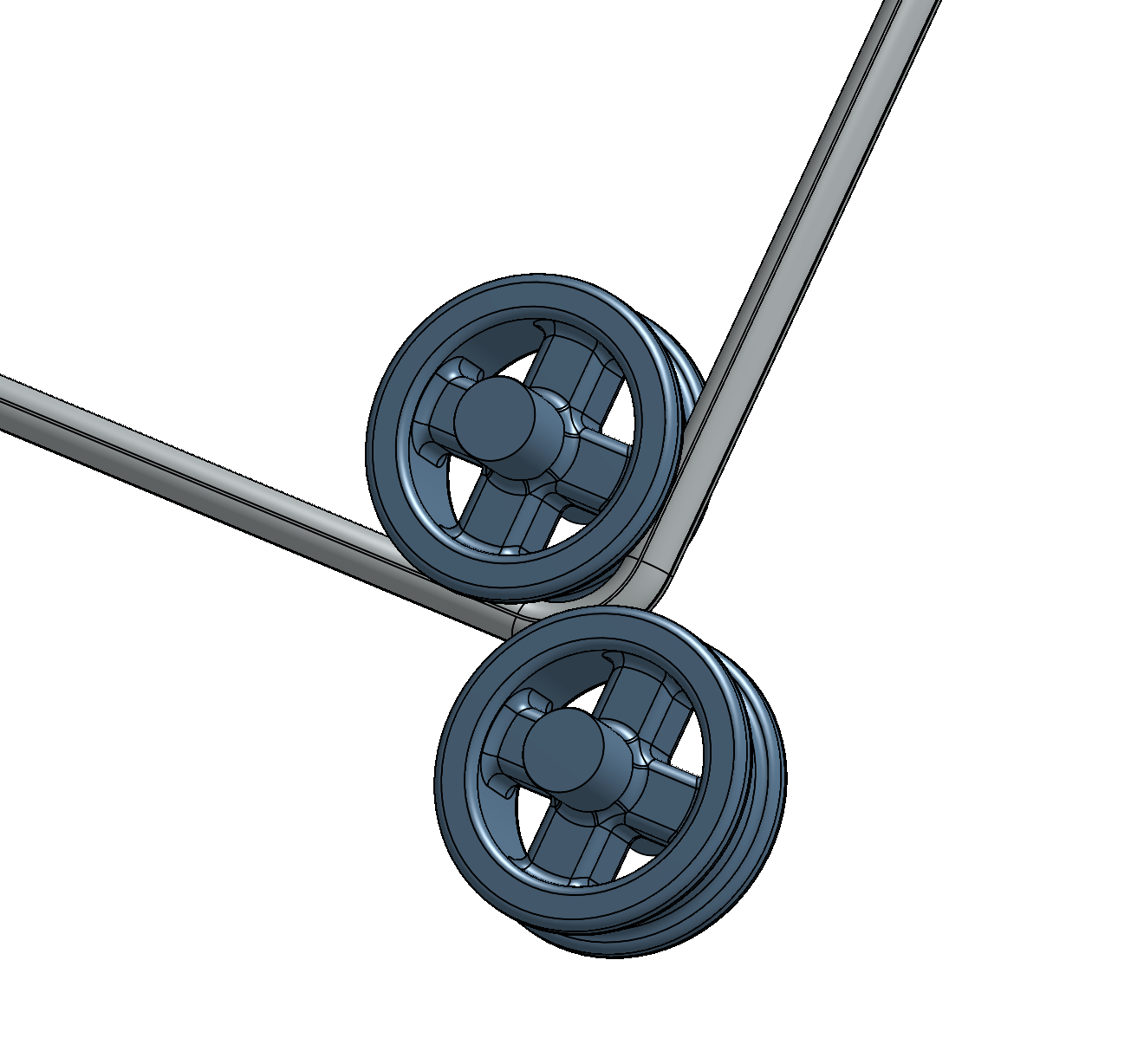

If you're intent on using the same nozzle, then you should consider a smaller non-ball type valve. Ball valves are good for their high flow rate and low turbulence, but you're going to have a difficult time getting a ball valve to work given the limited space. And using a smaller valve would probably be okay given how small the existing tubing leading to the nozzle is. The small size is probably the bottleneck in performance here.
One of these valves would probably work: https://www.mcmaster.com/valves/for-use ... ff-valves/
A system of pulleys attached to a trigger might be the easiest way to link the valve to a trigger.

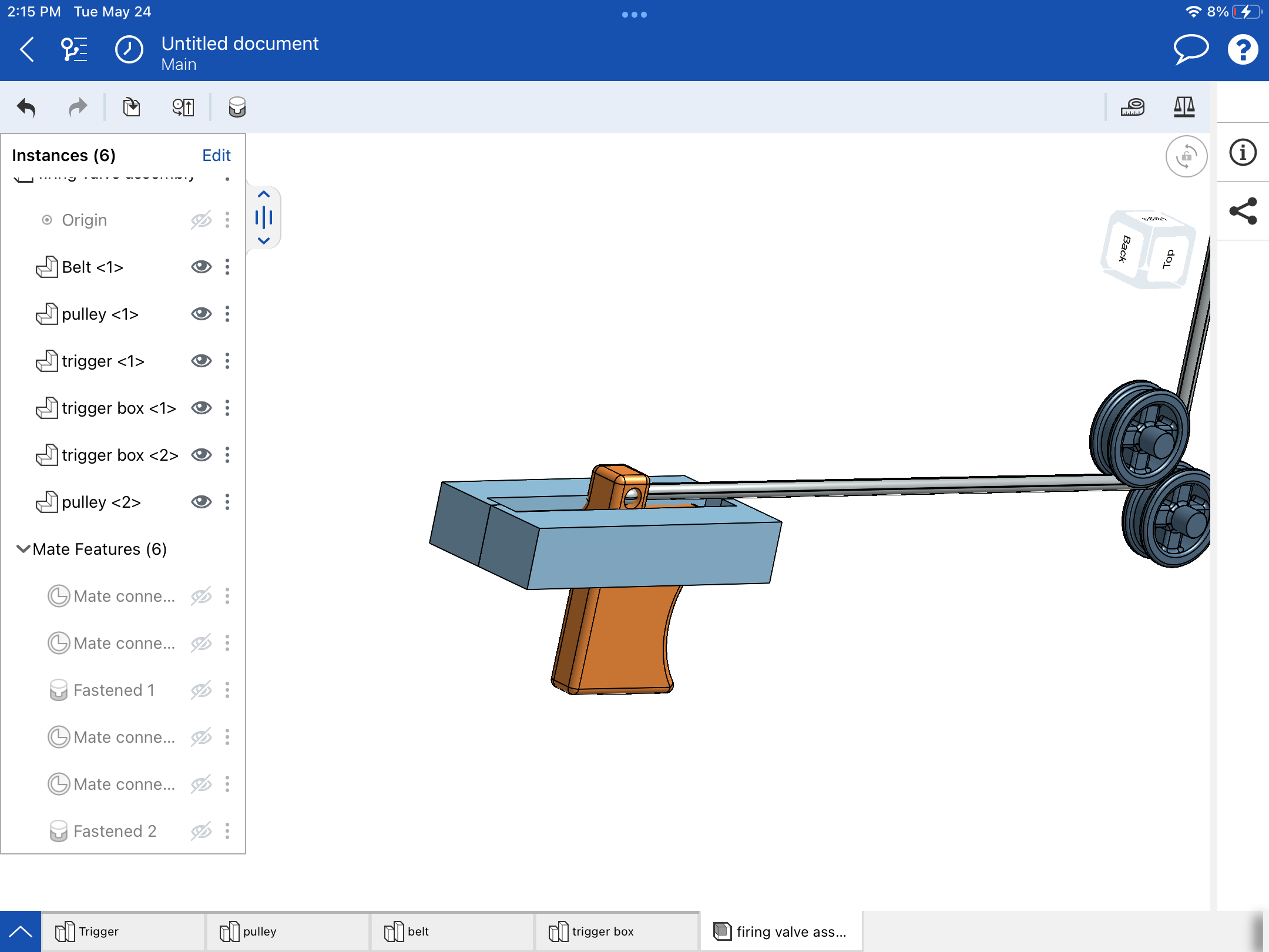

I think I will go with your suggestion I play around to see if I can figure out a good layout
Do the valves close by thereselves
Edit : any suggestions on how to do the PC
edit : this is what I figured would work for the layout just have to figure out what valve
[attachment=0]9CBE6F

If you are talking about the valves Ben linked to on McMaster-Carr, the page says at the top that the valves "spring closed when the lever is released". So you can assume that these valves do close by themselves.
As to the added pressure chamber, there are many options, but ultimately nobody here can recommend much without knowing more information. For example, what are the dimensions of the gap between the nozzle assembly and the reservoir? What locations could support the weight of a pressure chamber? Where could a pressure chamber be attached, in other words? The end-to-end length of those valves on McMaster-Carr is a bit less than 2.5 inches, so it looks like there is enough space for the valve at least, provided you can figure out how to mount it securely. But that still leaves open the question of where the pressure chamber goes.
Two other important questions to consider: What is your budget (both in terms of time and money)? What resources (tools, machines, workshop space, skills, computer software, free stuff, etc.) do you have on hand? All of these questions would inform the design decisions here.
A simple no-nonsense solution would be to create a kind of miniature APH-style pressure chamber, but connecting it to the rest of the gun depends heavily on other design choices, like what firing valve is used, what kind of tubing is used, etc. Something like an APH would be my first recommendation, but I can't think of a good place to put the chamber, especially if you want to keep the existing nozzle assembly. In all honesty I would just create a new gun from scratch!

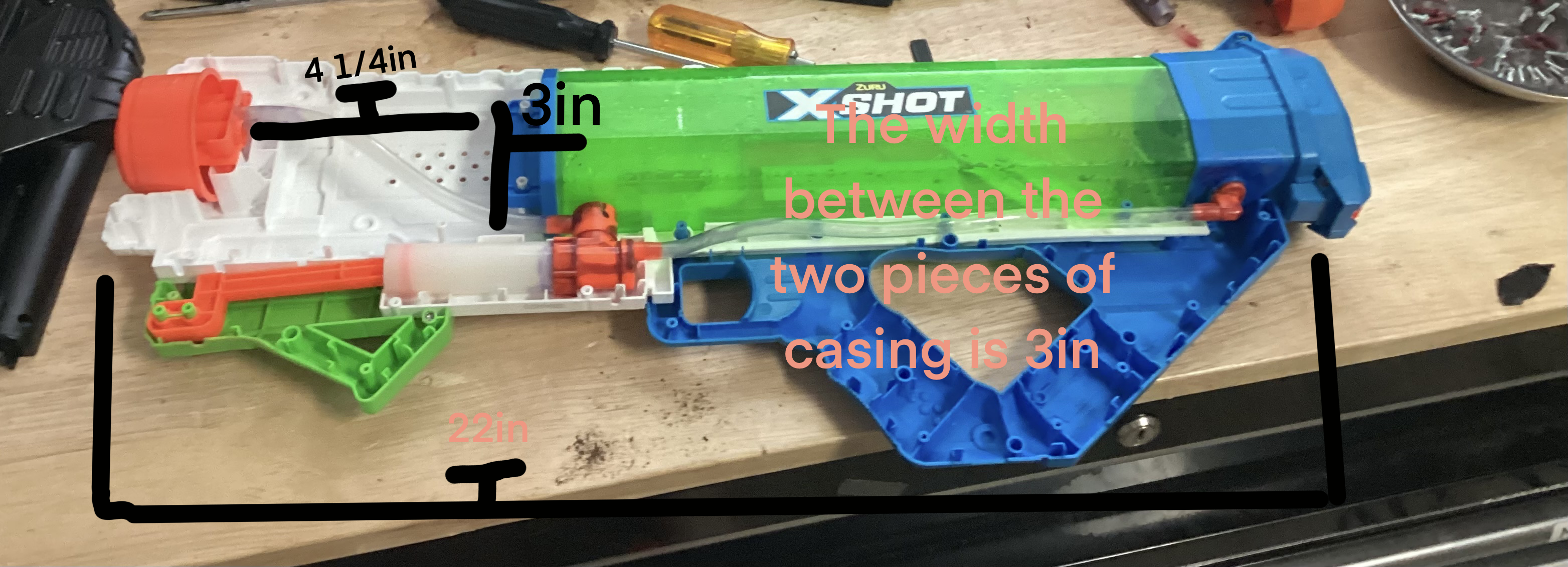

I have access to woodworking tools plumbing tools a 3d printer Metal working tools as far as a workspace I have a 10‘ x 10‘ workshop with a workbench and toolbox and I’m experienced with using all the tools that I have access to plus coding, building robots and fixing things on a farm,
My thoughts on where the pressure chamber would go is on the top of the gun kind of like this
Also here’s those dimensions
Also on the type of pressure chamber I was thinking about doing a CPH Style one
