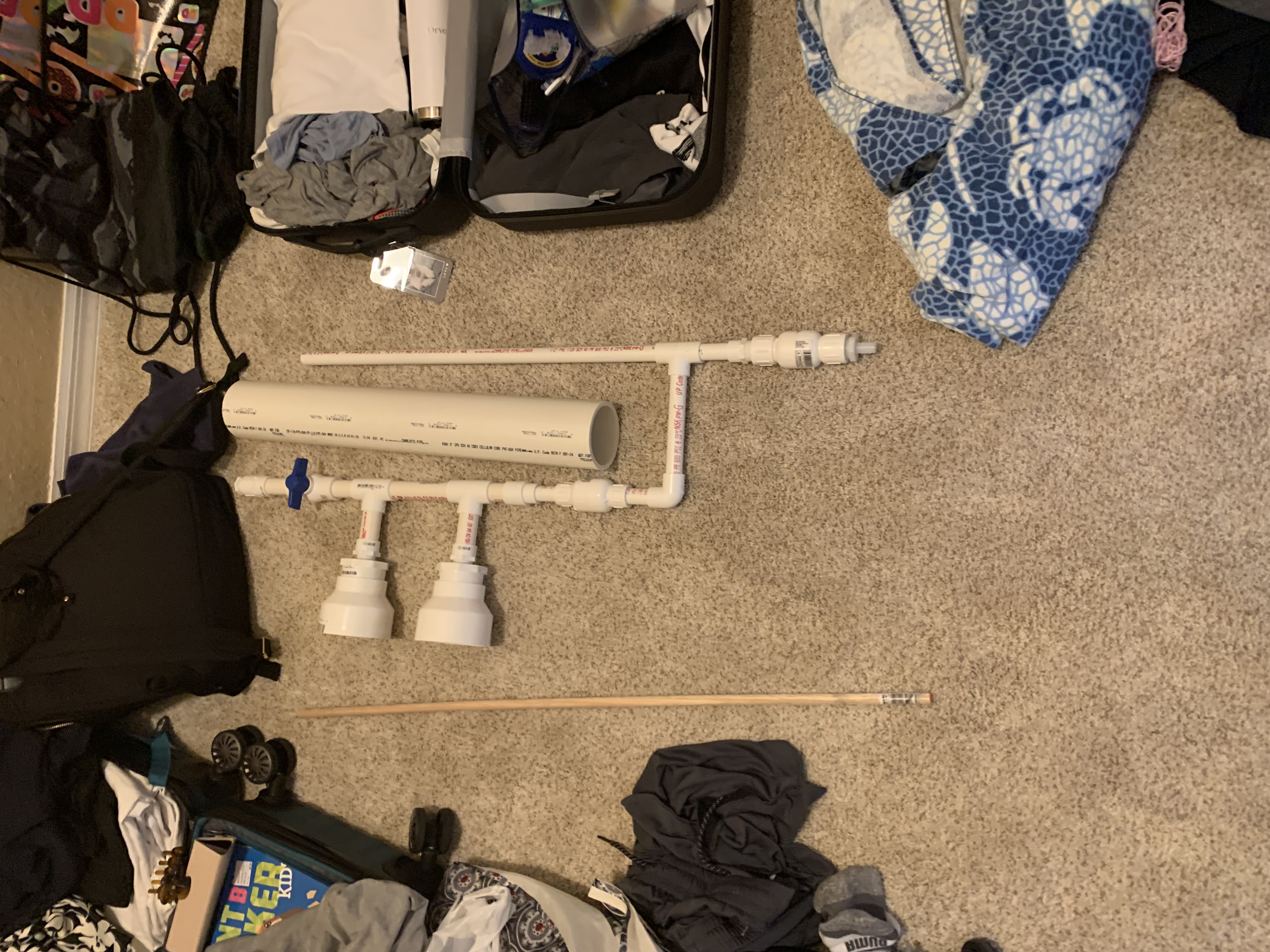

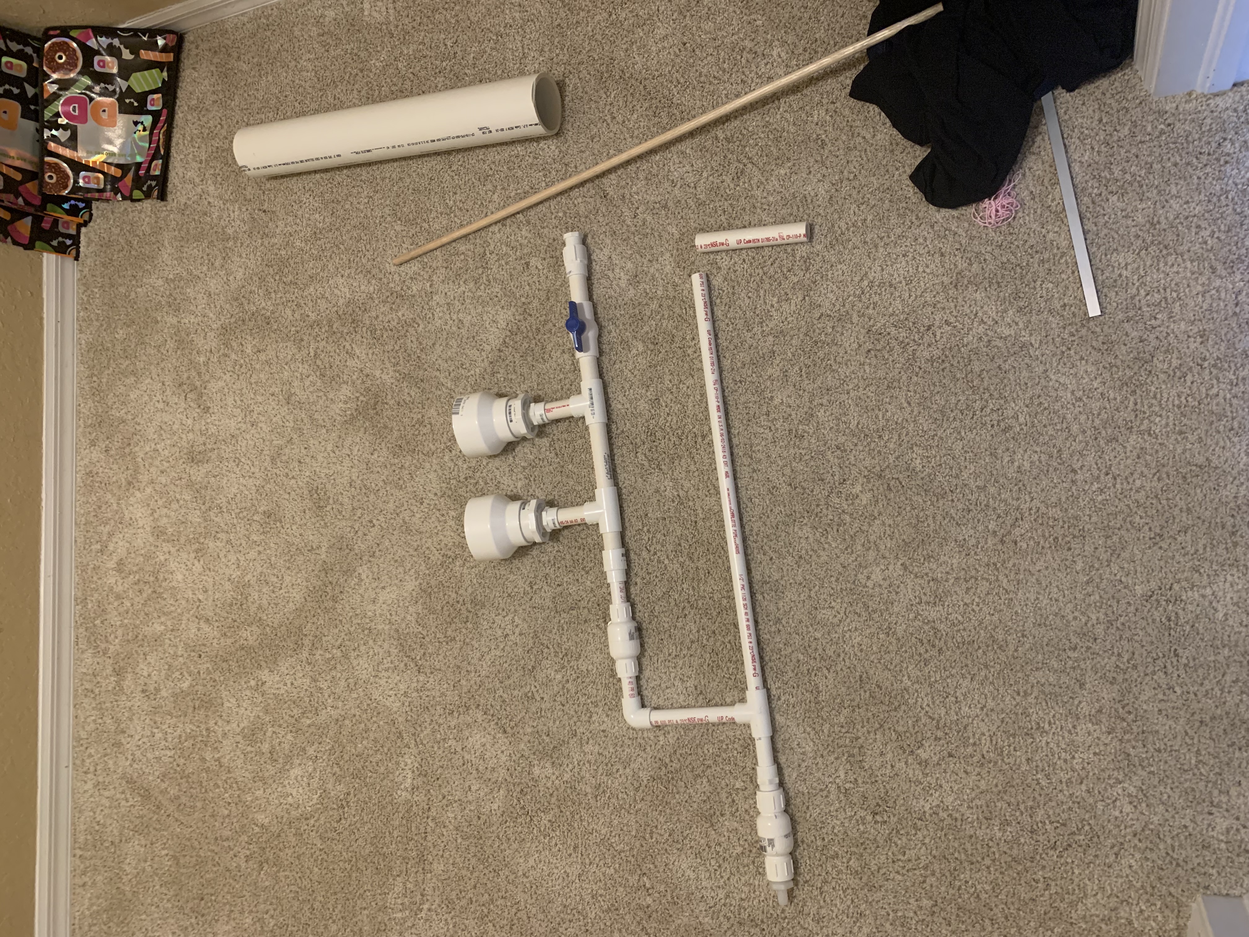

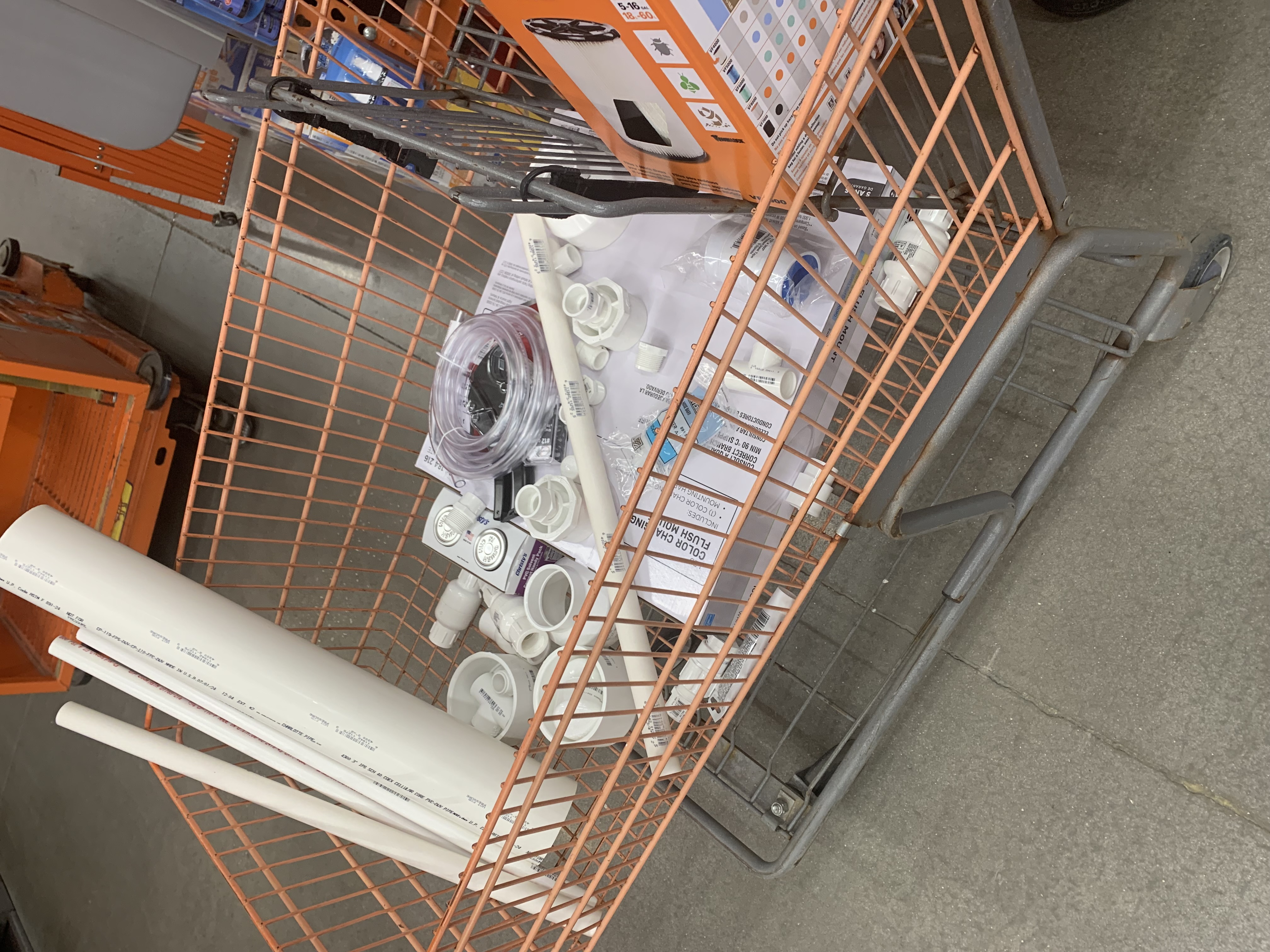

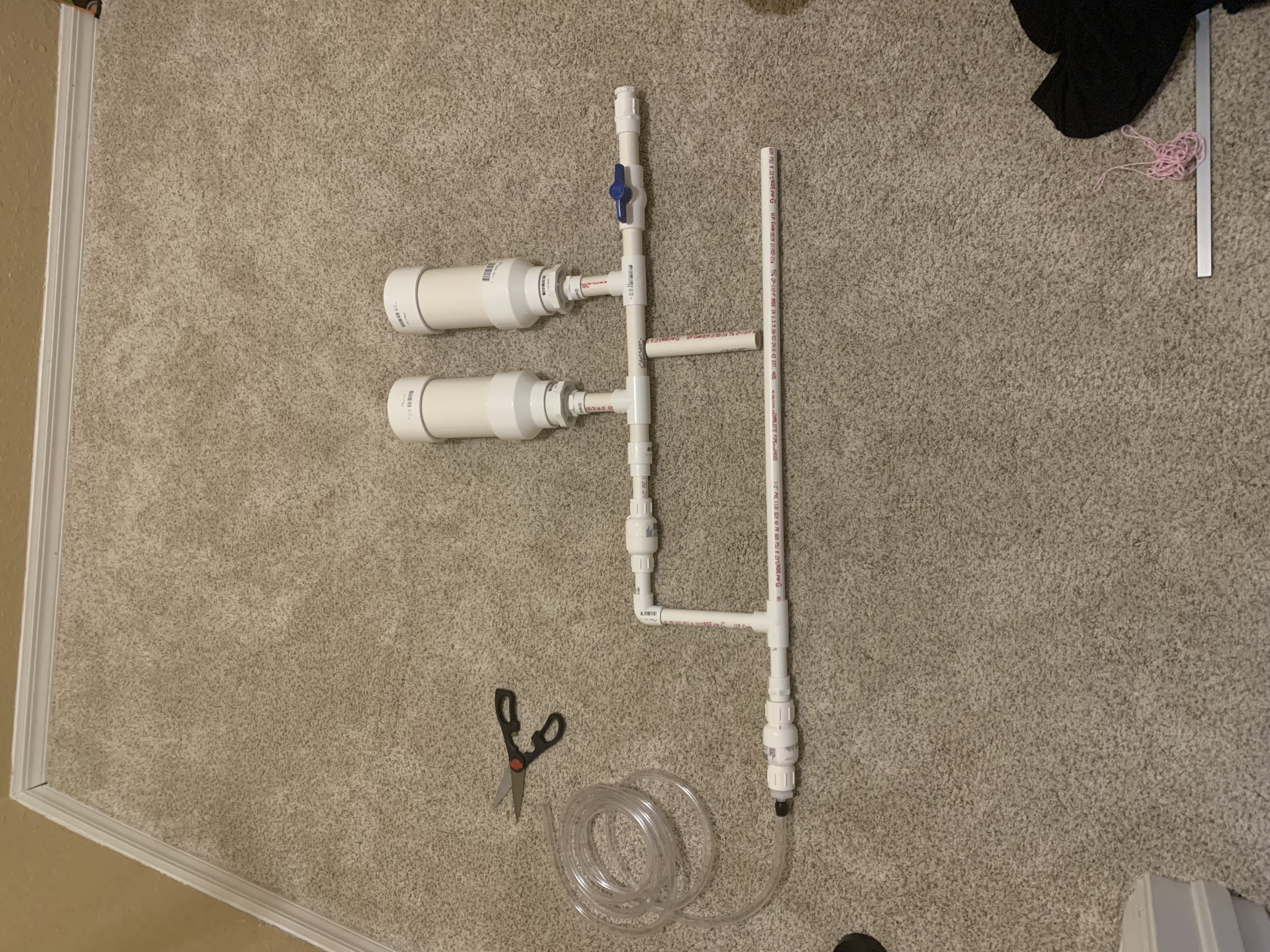

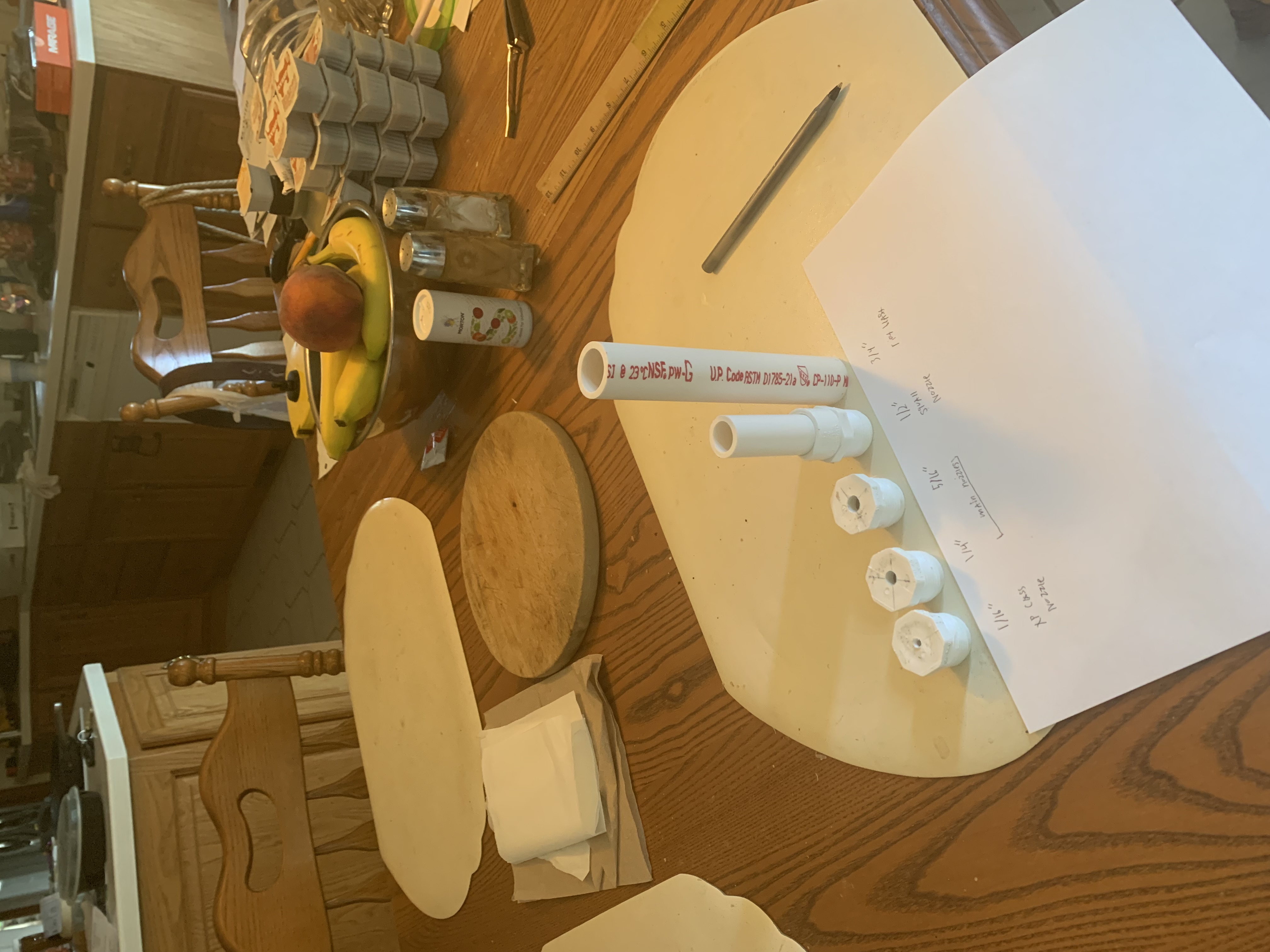

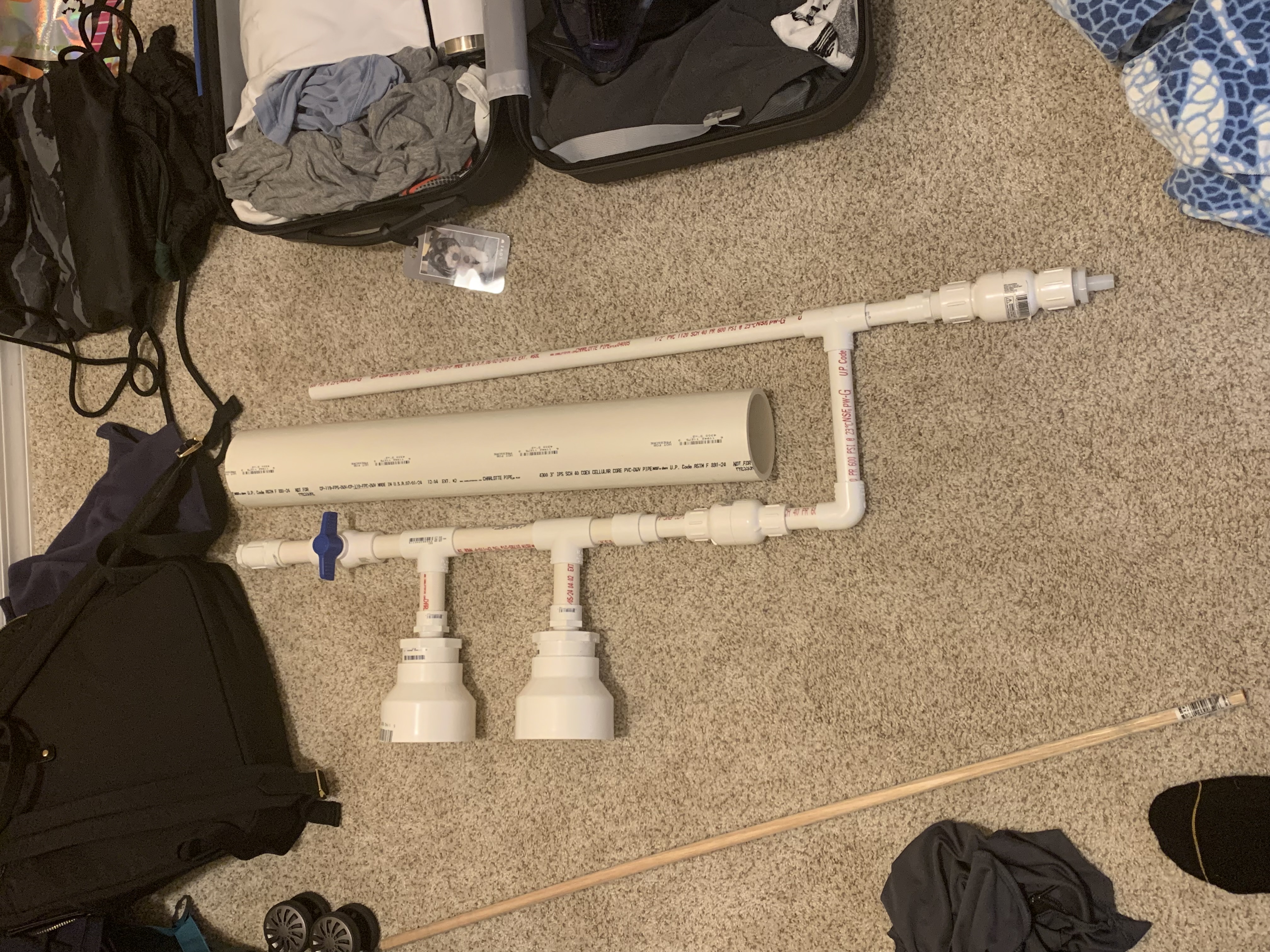

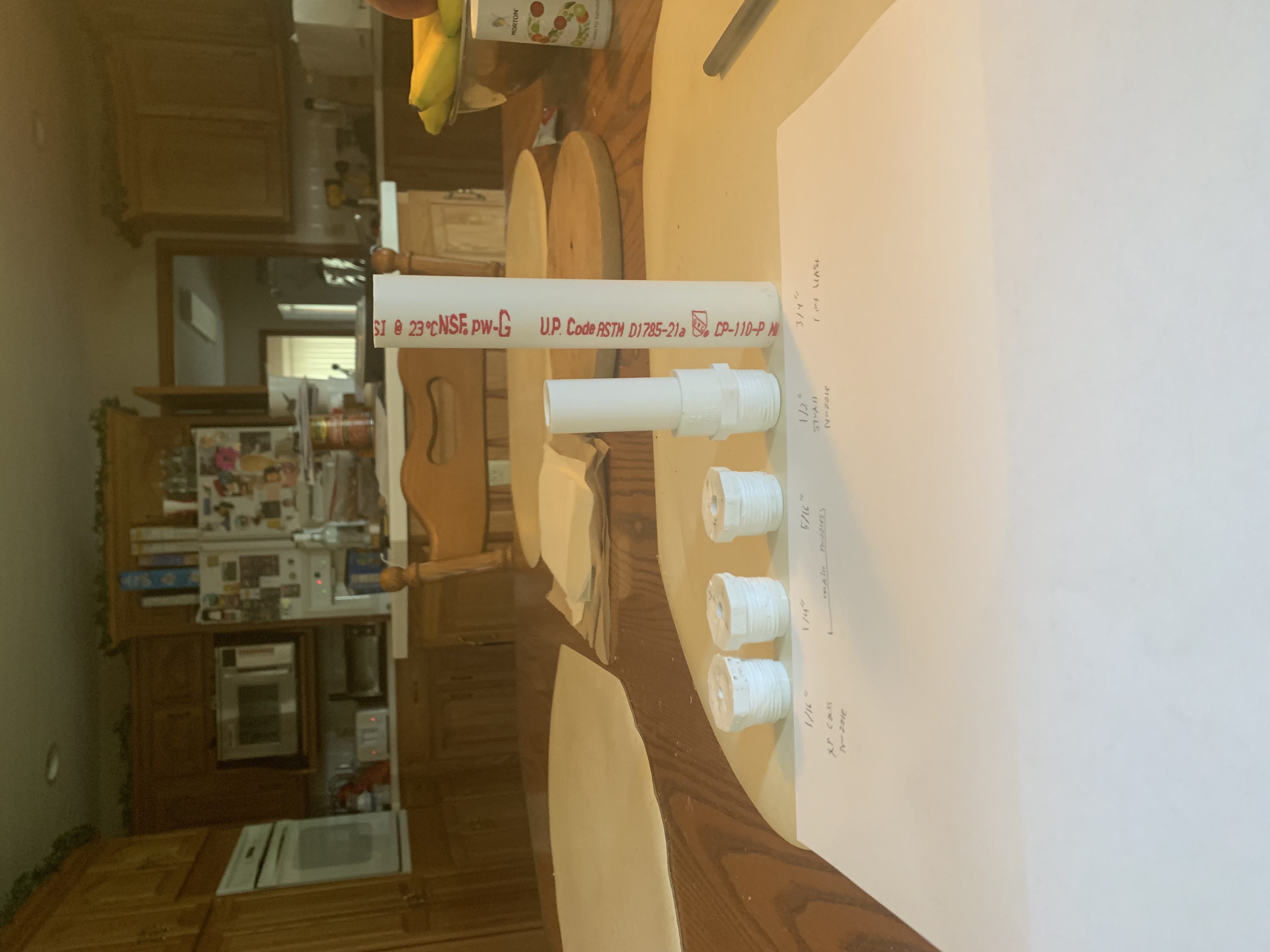

Recently building a APH, total cost in the high hundreds or low two hundreds. I could not find 3” sch 40 but I did find cellular core. There are a few differences however. I used only parts from Home Depot so that is something to consider. The pressure chambers thread since they didn’t have solvent ones. The nozzle instead of threading on it threads in. Love to here your feedback on this here’s some pictures
- IMG_2647.jpeg (3.16 MiB) Viewed 5469 times
- IMG_2645.jpeg (3.37 MiB) Viewed 5513 times
- IMG_2639.jpeg (2.61 MiB) Viewed 5513 times
- IMG_2640.jpeg (2.49 MiB) Viewed 5513 times
- IMG_2641.jpeg (2.79 MiB) Viewed 5513 times

I wouldn't recommend cellular core pipe for the pressure chambers. And the 3" to 2" reducers I used originally (same ones you're using here) usually aren't pressure rated, so I would suggest taking a different approach. You can find all pressure-rated components online easily (not easy in stores), say on McMaster. Instead of the reducing coupling and bushing you use now to go from 3" to 3/4", I'd probably end up using a big 3" to 3/4" reducing bushing like this on McMaster along with a 3" straight connector like this on McMaster. This will be heavier and more expensive, but much more durable and safer. You can verify these are pressure rated by checking the "Specifications Met" for "NSF/ANSI 61" or "NSF-pw" (also written on the pipe and fittings).
Fortunately, even if you've cemented everything together, with threaded pressure chambers, you can swap them out later. And the pressure you can get with a hand pump usually aren't an issue even with non-pressure rated components, or at least I haven't heard anything on that. (Non-hand pumped things are another story entirely.)

Thanks for responding Ben. Currently I have cemented and used the water gun and I have good and bad news. Now don’t worry nothing exploded and no one got hurt. The good news is the riot blast is very good and is on par with a flash flood riot blast. The bad news is that the main nozzle is sub par for homemade standards. I have a couple theory’s why this is. Number 1 I have only pumped it up to half power due to the screw in chambers leaking at the joint. This could be fixed however I’ll just add Teflon to the joints. Number 2 is potentially what could be a debilitating issue that can’t be fixed for this homemade. This being the fact that the male screw in joint is smaller than the 3/4” tube that the chambers release water into. This I imagine is a major inefficiency in this APH that could be contributing to this. Besides that though the screw in pressure chambers I see can be a tactical advantage on the battlefield so I’ll have to try out swapping. Lastly the pump I made extra long because i believe that long pumps can do things that short pumps can but not vise versa. This may not be true but it’s what I see. I have 2 short videos of the gun shooting but I’m not sure how to post them here. But that’s pretty much it since this is a short essay at this point.

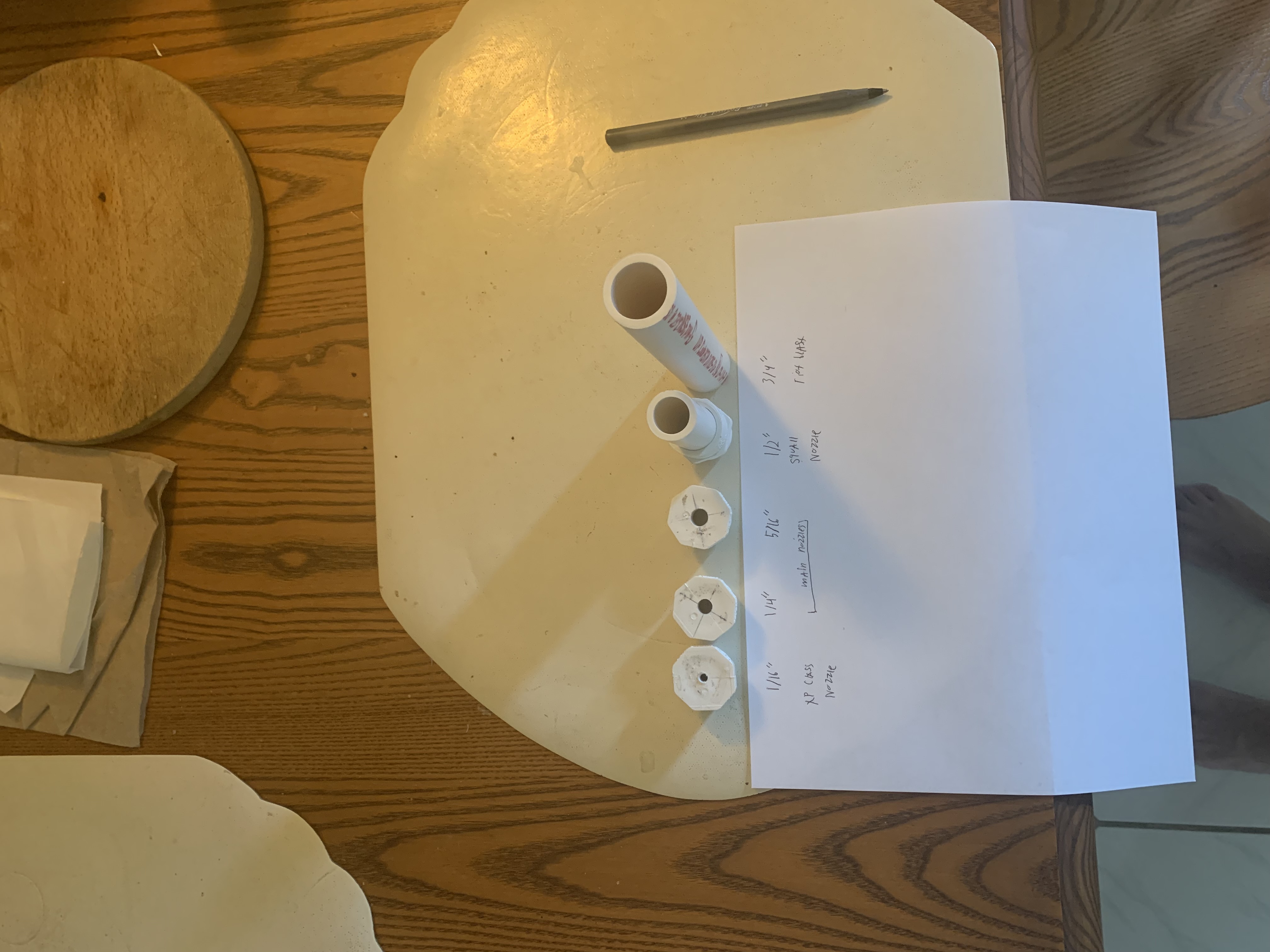

Quick update I’ve fixed the issue turns out Teflon did the trick. Now I’m getting great range and power. The riot blast now is even more potent and I’ve made some nozzles that I would like to share.(note this is subject to change I will make more as time goes on.)
- Side view
- IMG_2668.jpeg (1.78 MiB) Viewed 5238 times
- From left to right
1. 1/16” nozzle- gets great range and shot time with the drawback of less output
2. 1/4” nozzle- great output and range with average shot time, an overall great nozzle
3. 5/16” nozzle- impressive output and slightly less shot time with the same range
4. 1/2” squall nozzle- honestly a very fun nozzle to use it has the power of riot blast with better range than one might expect, overall impressive nozzle for just being press fit together (and it smokes compressed air which is kinda scary)
5. 3/4” riot blast- no need for an introduction lives up to the power of all riot blasts draining water in an instant, soaking everything in its path, great if up close - IMG_2667.jpeg (1.22 MiB) Viewed 5238 times
- Corner angle
- IMG_2669.jpeg (1.41 MiB) Viewed 5238 times

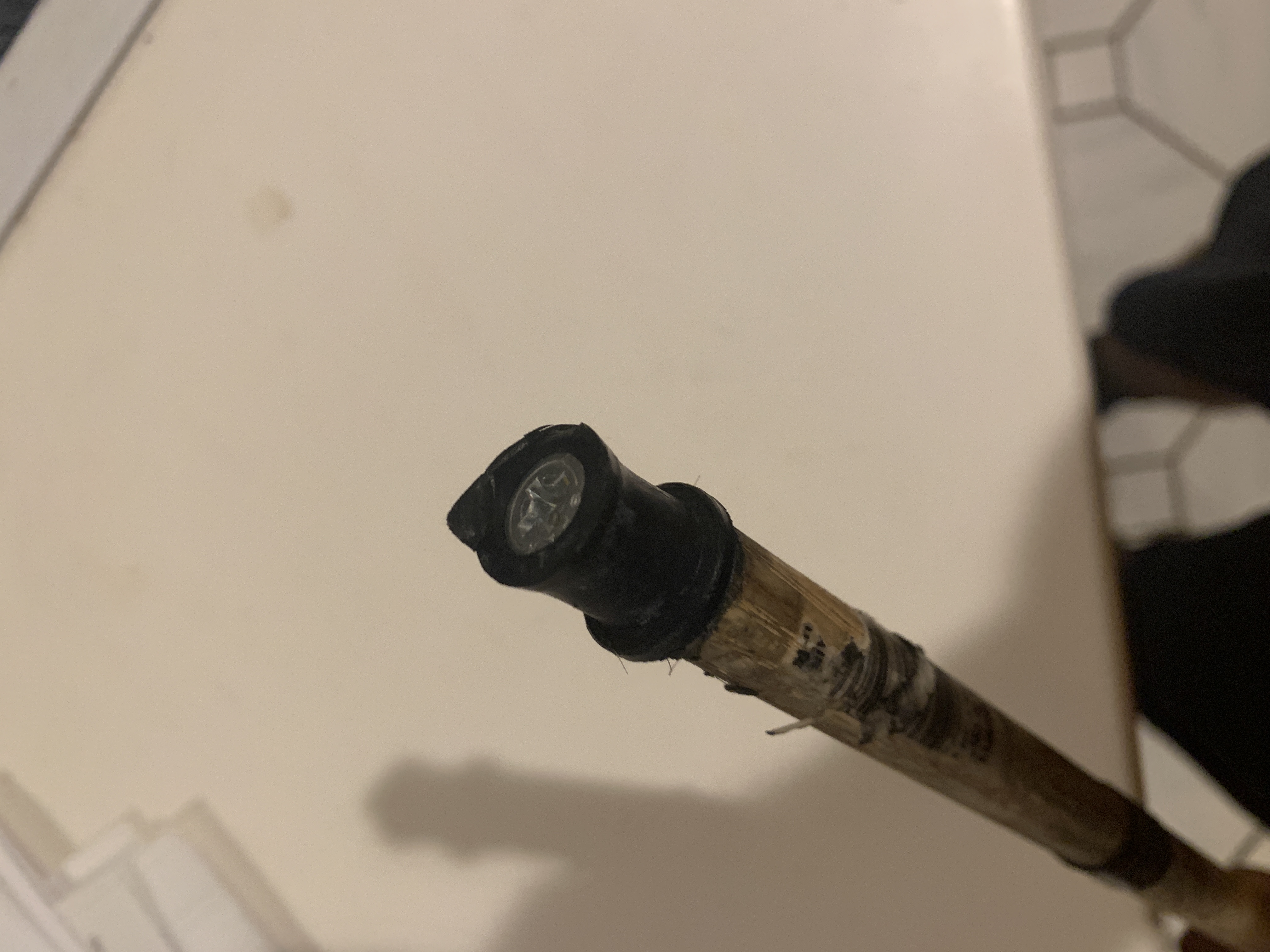

just made 2 videos of me shooting the gun with the 5/16" nozzle and the 1/2" Squall nozzle, i am not quite sure how to post them here but if you guys know how id like to know. i measured the range of my APH and i can say the 5/16" nozzle shoots 45 feet, im not sure if this is on par for a APH so id like to hear you're feedback on this as for the Squall nozzle it over preformed shooting 36 feet basically being a concentrated riot blast. so id also like to add that for this pump i used a single top hat rubber grommet fixed into the pump shaft by a screw ill post a picture of it, as far as i know its a unique design as far as using a top hat grommet and it seals really well. anyways i hope for a good soaker season coming up as its looking very promising.

- IMG_3004.JPG (2.6 MiB) Viewed 2336 times
