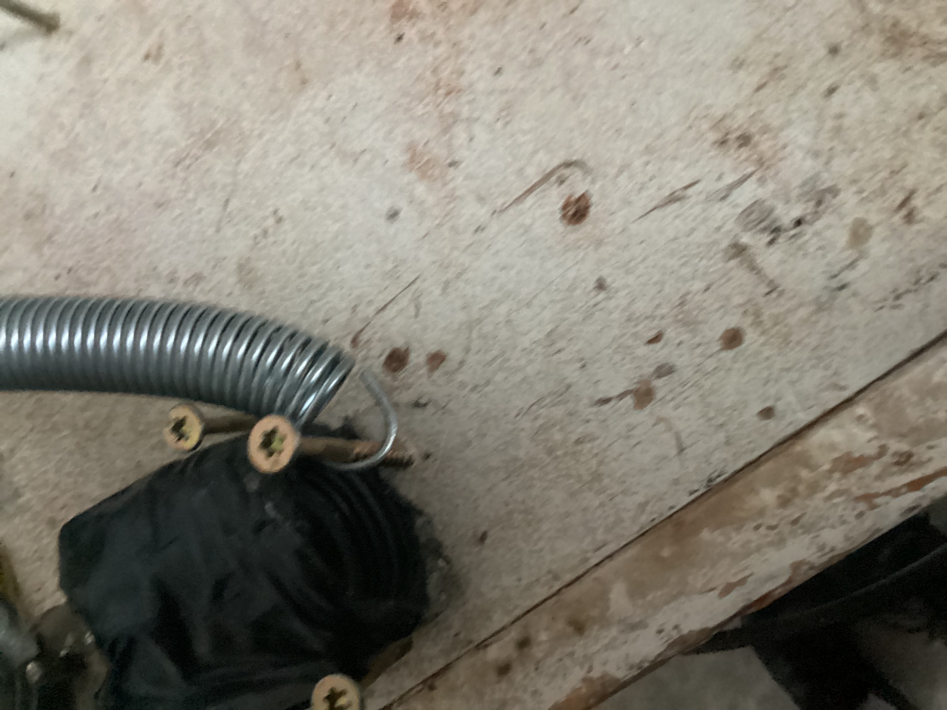

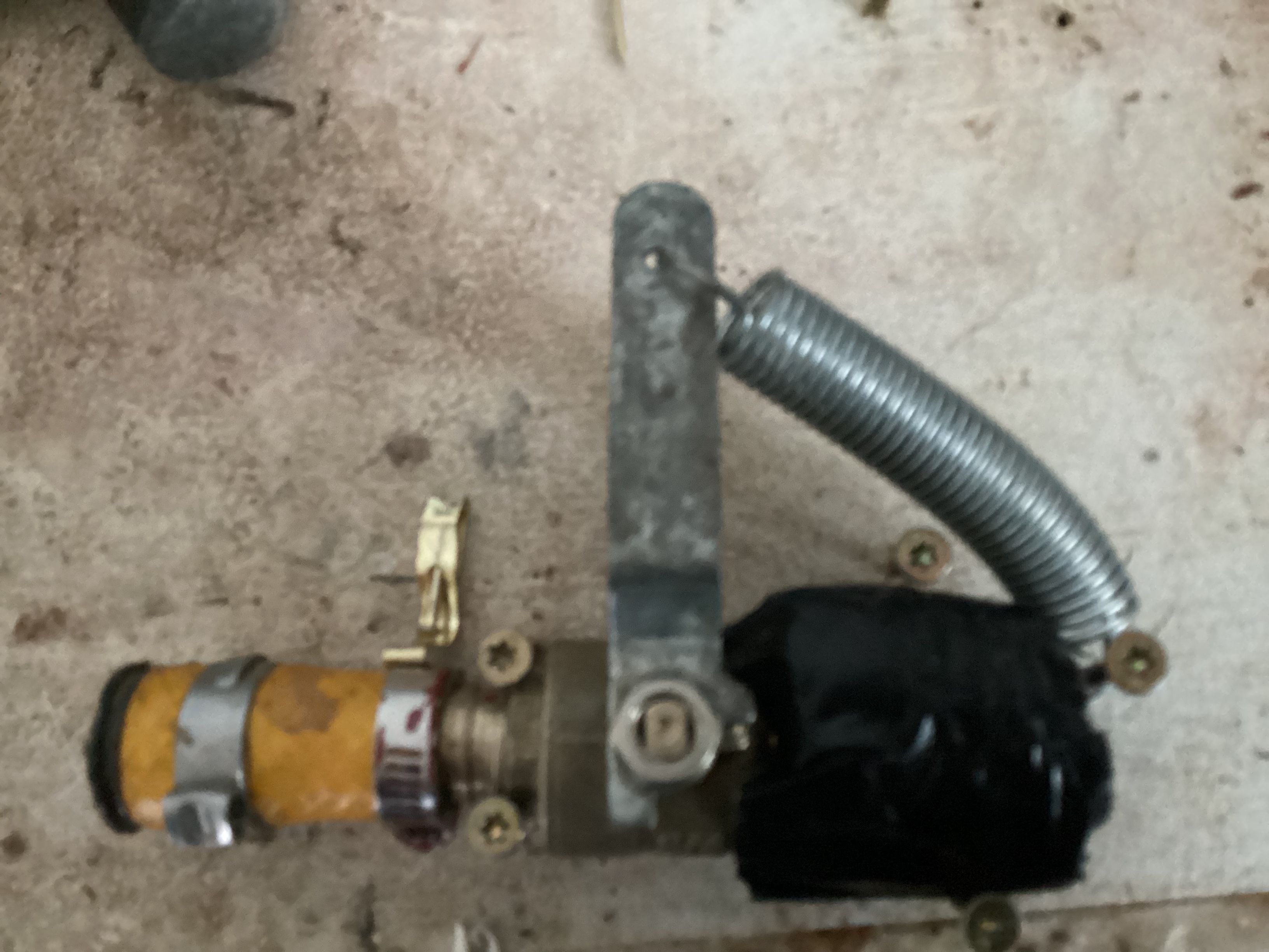

so as i save up money to get the parts i have been doing testing with what i have and yesterday i was trying to get a 3/4 ball valve to close with a spring and it worked
here some photos
here a video of it in action

That's an interesting way to mount the parts! Prototyping and testing are always good idea. I'd take some measurements to make sure you can replicate it when it's no longer mounted to the table.
Could you explain the photos a bit more? I am confused about what the pieces are at either end of the ball valve. Which way is the direction of the flow (which way would the nozzle point)?

Post by SSCBen » Wed Aug 31, 2022 10:57 pm
That's a strong spring. I'd recommend using a weaker spring as you don't need one that strong to close the valve and the trigger will probably be hard to pull with this spring. Also, this spring could be dangerous. Be careful with this spring in the current setup. Your current setup is putting a lot of torque on the screw. The screw could be ripped out of its hole and cause serious injury. When building the blaster, be sure that the spring is firmly attached, preferably from both sides of the blaster.

The yellow part is the nozzle and the black part is from a host sprayer attachment to hook up to the hose I made it. I just put some pieces together I don’t have much right now. It’s for a fair. It just hooked up to the hose and has a ball valve for shut off. It goes into the upcycling category. If it wins it’s category I get $30 which will go towards the gun
I agree my robotics team just had a box of Springs and I saw this so I asked if I could borrow it I have to look for a weaker one
I was thinking the same thing
