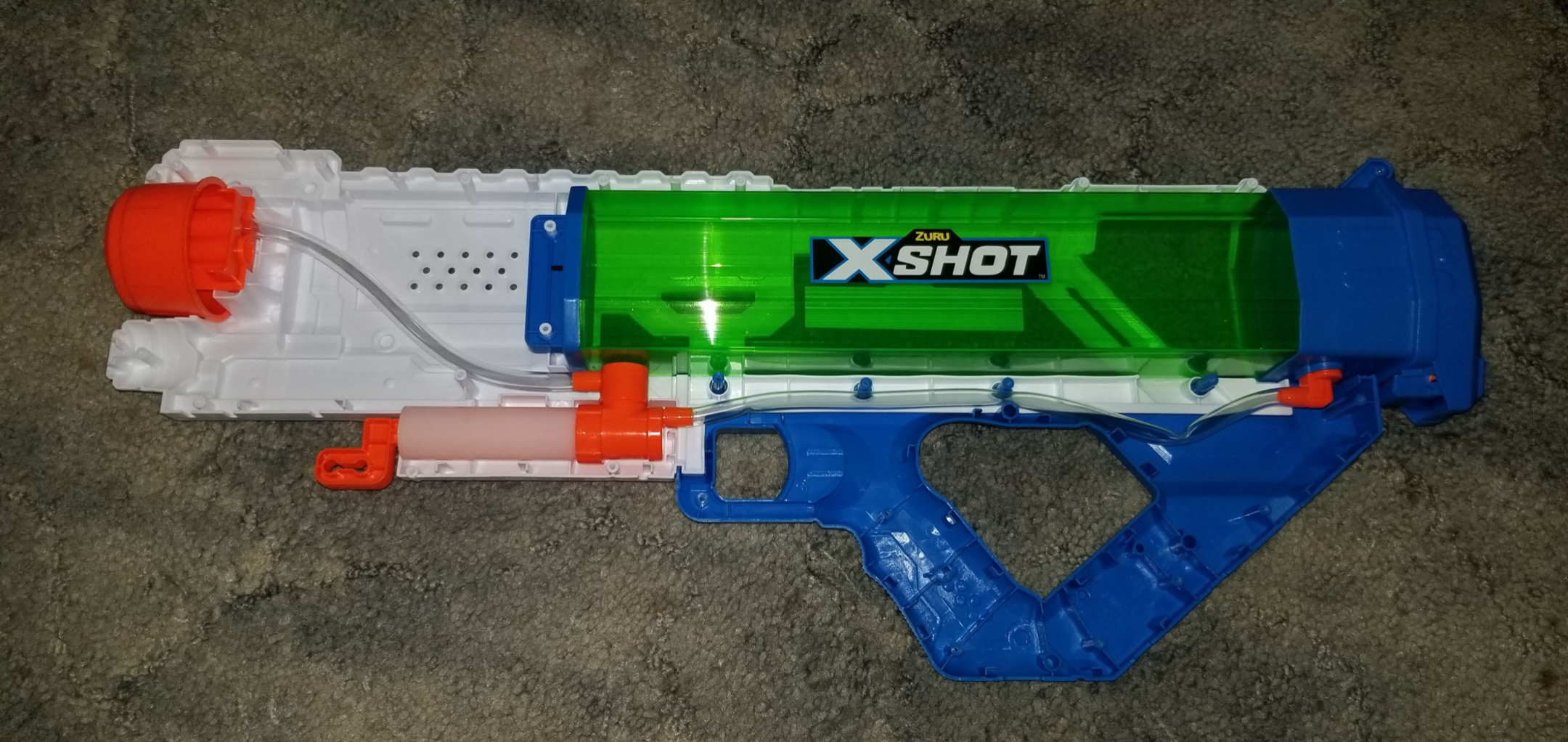

Post by Zman » Thu May 26, 2022 1:24 pm

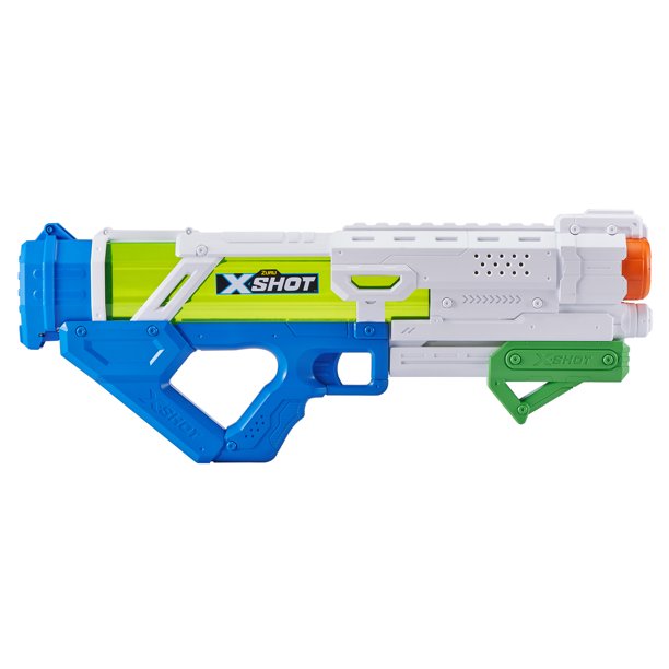

My goal is to make a CPS blaster by using pieces from a XSHOT blaster and spending $60 on the rest of the pieces.
Pieces that I am using from the XSHOT blaster are
The case.
Reservoir.
Nozzle assembly.
Pump.
Some of the tubing.

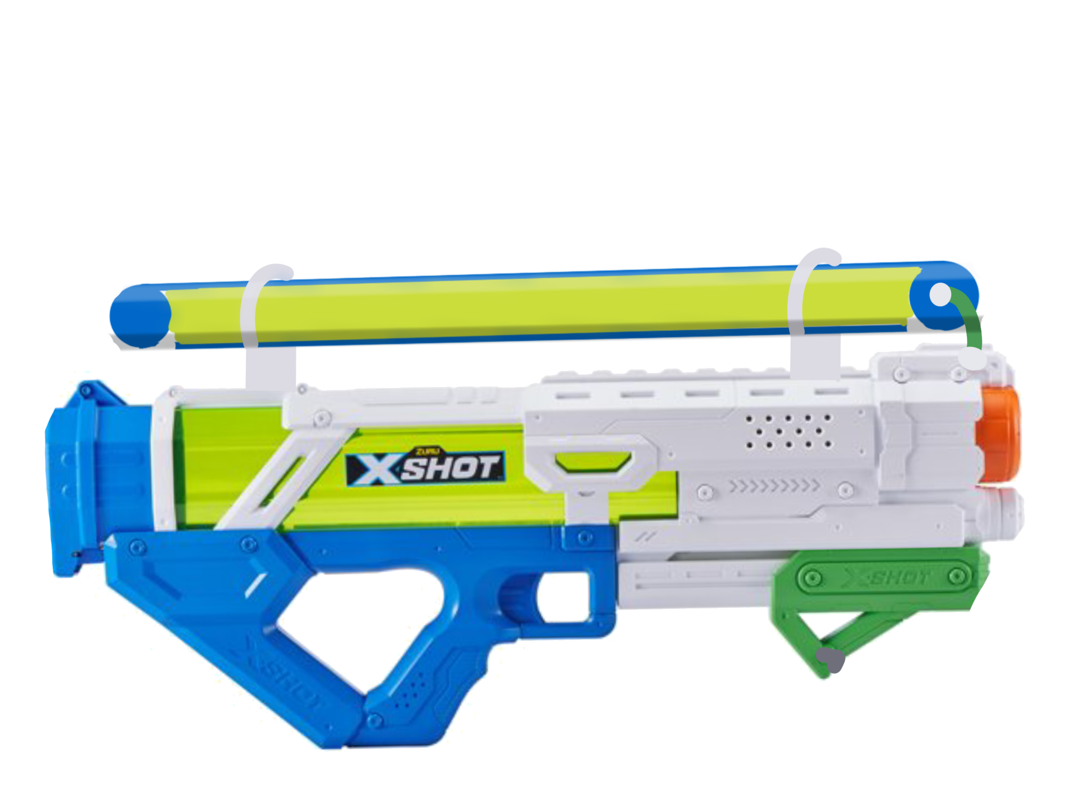

The first thing I want to figure out is how to mount the PC. this is my current idea.
Once I have that figured out I want to figure out the firing valve my plan is to use a trigger to open It. this is what I have so far.
Here’s some photos of the blaster.
Any ; feedback, questions, criticism, is welcome.

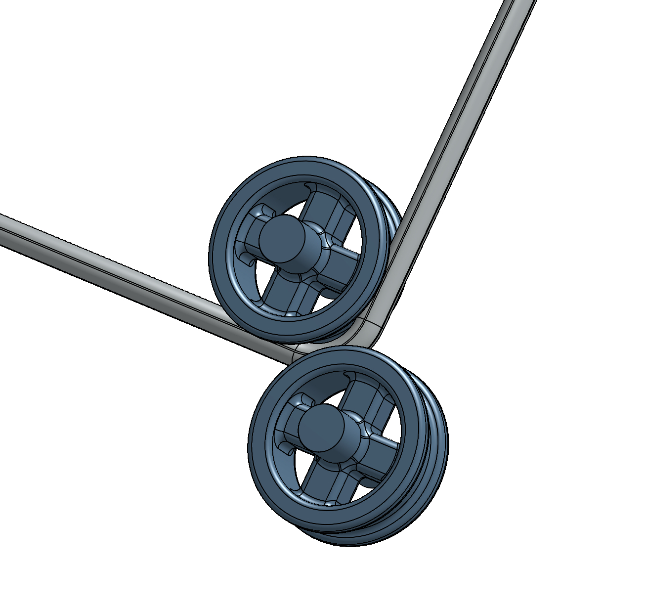

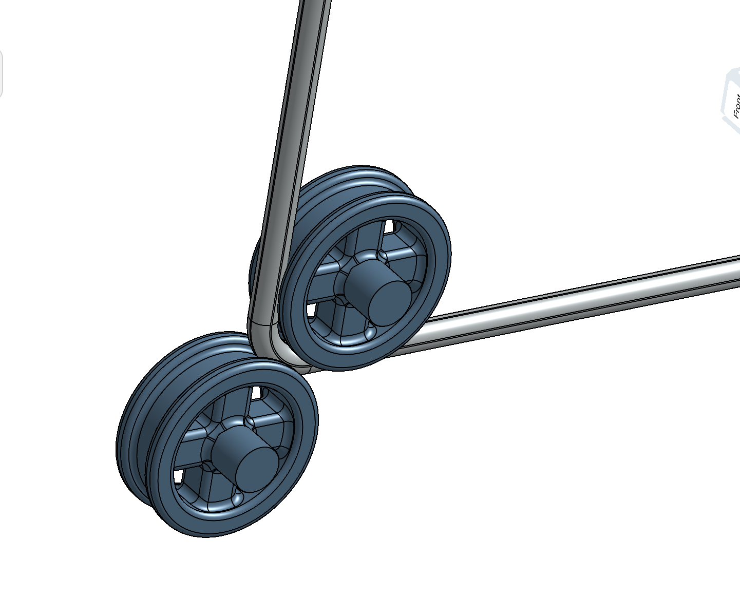

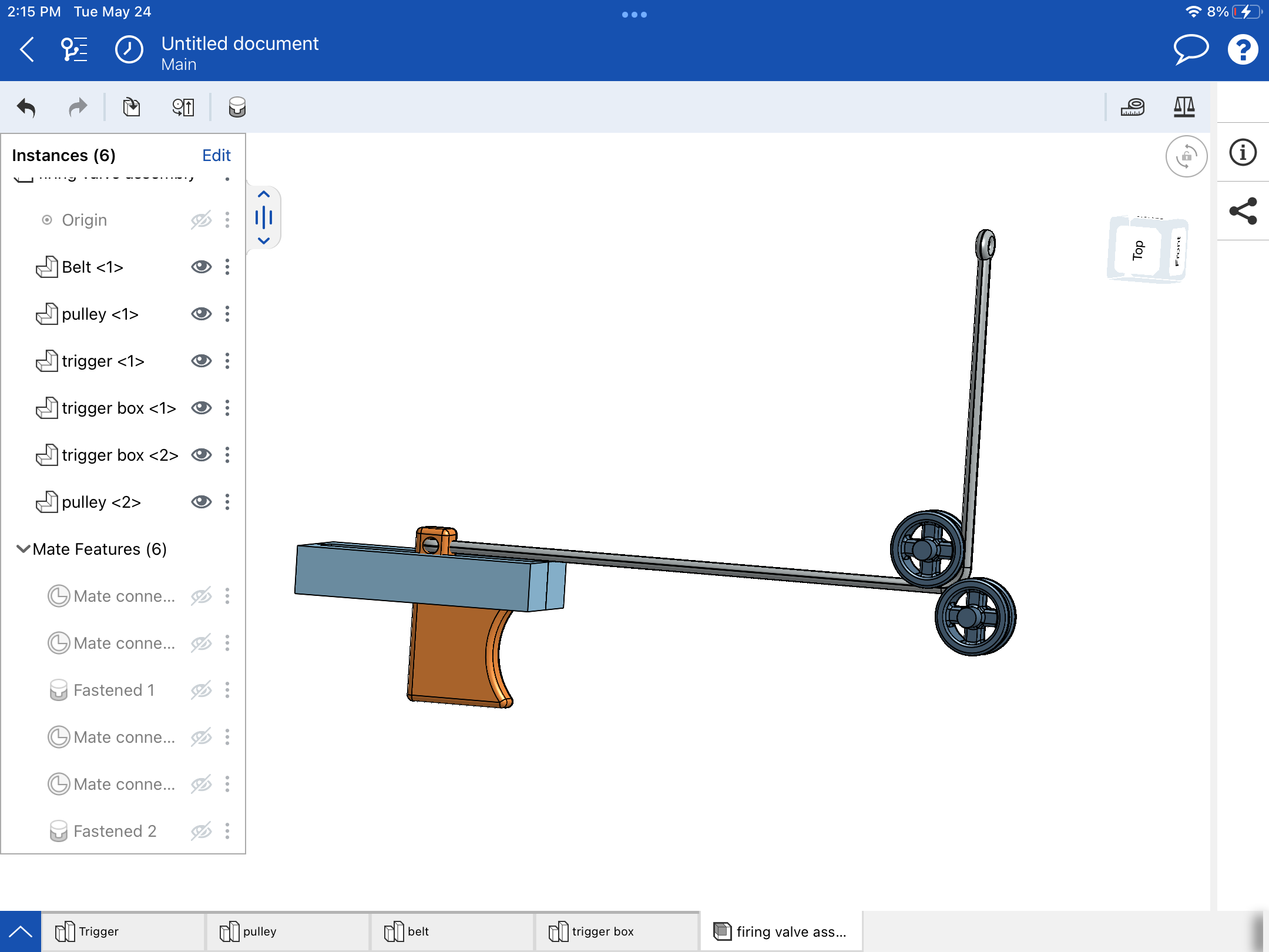

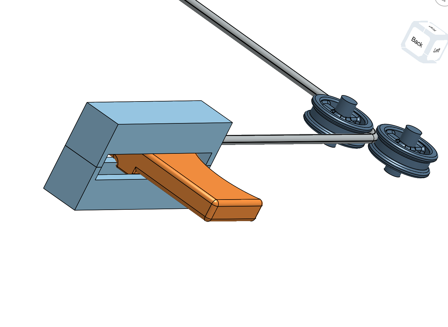

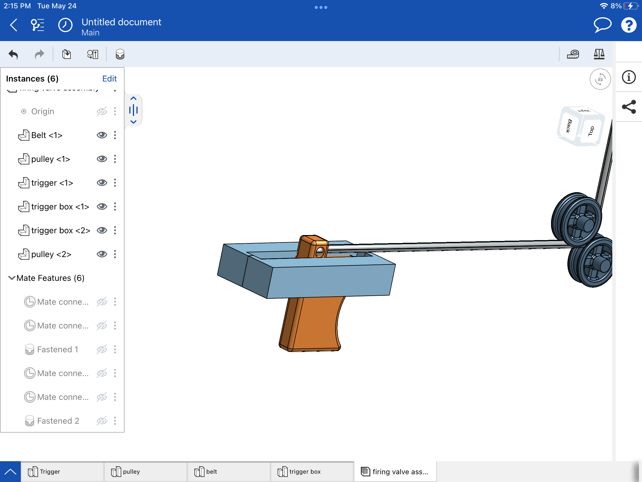

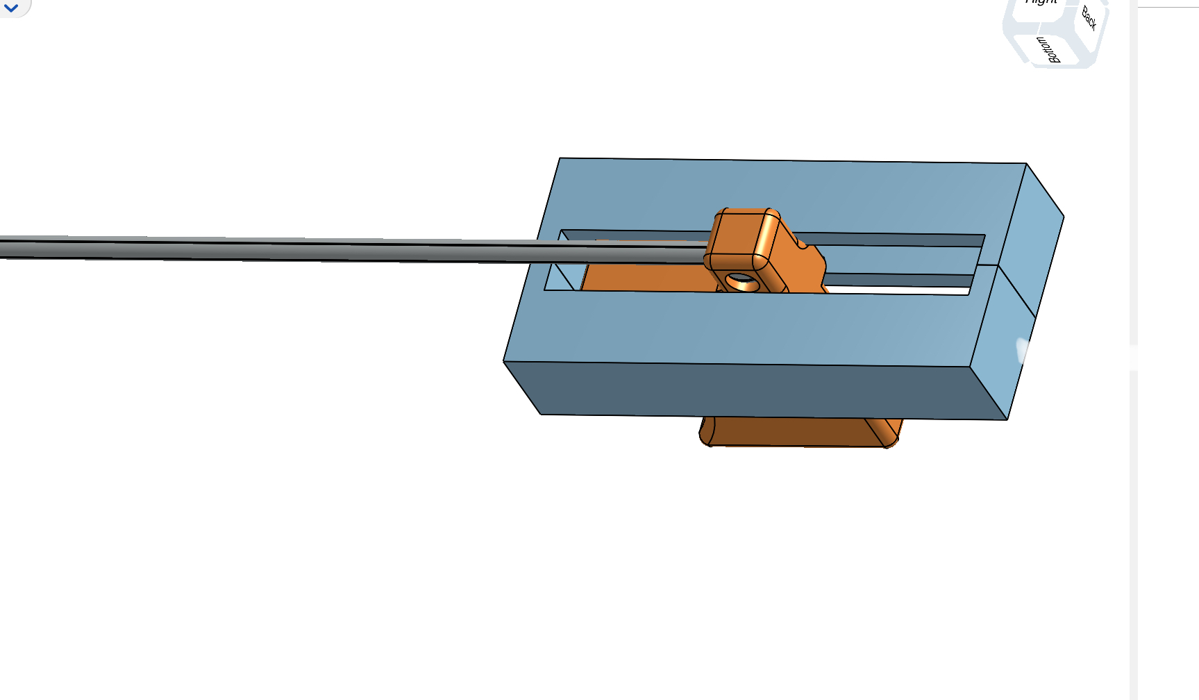

Major update
First starting with the pc I decided to mount it to the top with Bolts
I’ll be using two layers of LRT with the outer one having the ID that matches the OD of the inner layer from McMaster
As far as the firing valve i’ll be using a ball valve with a custom handle attached to a rod that will have springs to reset the trigger attach to the rod will be rope attaching to the trigger
I’m pretty sure that I will not need any check valves if wrong please let me know all I think I need is listed ⬇️

Re: Semi homemade CPS with pieces from a XSHOT blaster
Post by SSCBen » Sun May 29, 2022 10:11 pm
Zman wrote:
Sun May 29, 2022 8:57 pm
You'll have a lot of trouble getting the outer tube over the inner tube if the ID matches the OD. The ID of the outer tube should be a bit larger.
Also, because the nozzle is so small, it's probably not worthwhile to have two tubes. It might not increase performance that much because the performance is limited by the nozzle, but it would add cost and be harder to pump. Two tubes might even decrease performance if the pressure is too high for a nozzle of this size.
As for the remainder, I think you'll have a lot of trouble getting an off-the-shelf ball valve to work. Again, my suggestion is to use a valve that'll be easier to get to work with a trigger. Ball valves can be difficult to use a trigger with. It's also hard to comment about if any parts are missing. If you're missing anything, you'll know when you're building.
Post by Zman » Mon May 30, 2022 2:35 pm
You'll have a lot of trouble getting the outer tube over the inner tube if the ID matches the OD. The ID of the outer tube should be bit larger.
How much range would you get with just one layer
I can always increase the nozzle size but I’m might just be good with doing one layer
through testing I’ll was able to find out the angle that you could pull it at and using the custom handle that I will have photos of the CAD for it Soon
The rest of the trigger part I will have to figure out no matter what valve I use
Any other comments are welcome
Post by SSCBen » Mon May 30, 2022 5:08 pm
I'd guess you'd see a range of around 35 feet, maybe low 40s. It's hard to know without testing, though. I could get about 42 feet with a single tube in this basic homemade water gun.
You could experiment with larger nozzle sizes and two layers, but as I said, I'm not confident adding a second layer will increase range that much.

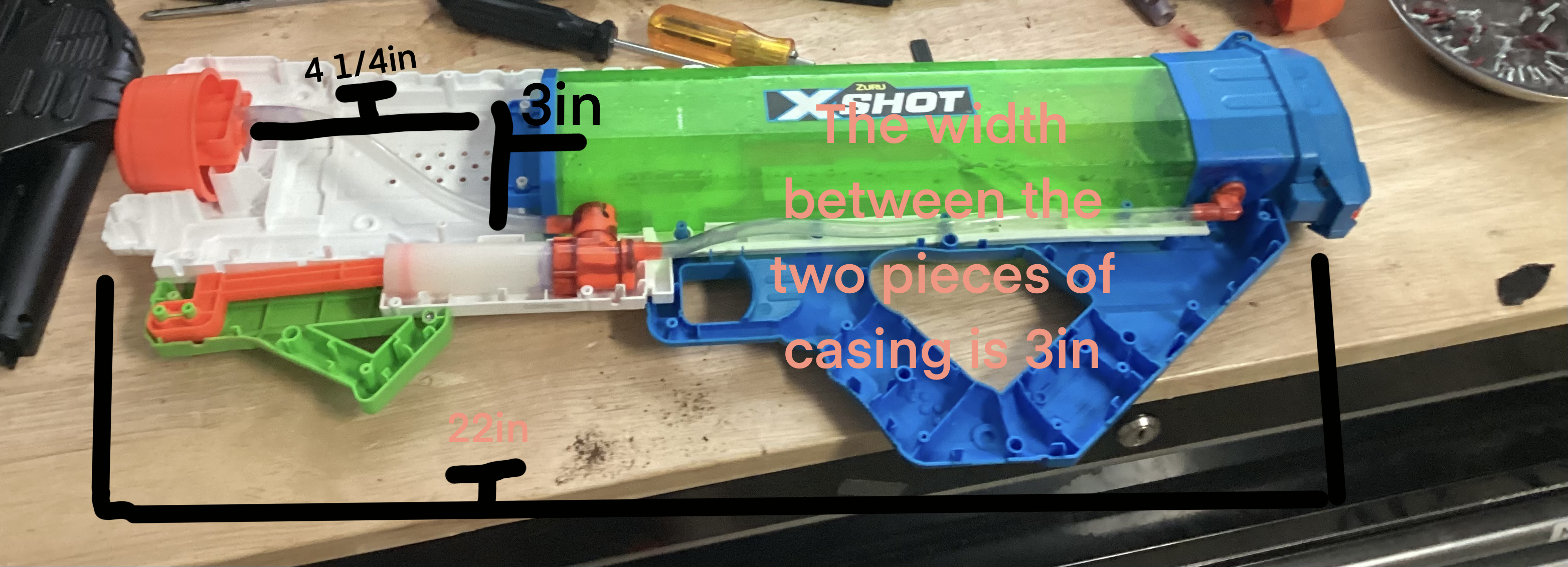

Post by Zman » Mon Jul 04, 2022 1:06 pm
I have a Few questions
First : I’ve going for two layers of LRT what Should the ID and OD be for the first layer and what should the ID and OD Be for the second layer
Second : what should I use for the PC case
Third : What size of fitting should I use for the part that connects to the LRT
Fourth : What pressure rating should the tubing be
A Janky soaker is the best kind of a soaker
Drenchenator
Posts: 258
Post by Drenchenator » Tue Jul 05, 2022 7:19 am
1. This depends on the performance you want, but if you are going to layer the inner tube should have an outer diameter less than the inner diameter of the outer tube. You won't be able to slide the inner tube inside the outer tube otherwise!
2. I do not know what others will say, but I've had success using 4 inch PVC drainage pipe. It is rather thin and lightweight but roughly a good diameter for one layer of LRT. One layer of LRT expands to just over 3 inches in diameter; I do not recall how much two layers expands, though.
3. Again, this depends on the performance you want. A larger diameter would support a higher flow rate. While it is possible to stretch the tubing over a larger barb size, I suggest using the inner diameter of your inner tube as the barb size due to the difficulty of using a larger barb size.
4. Again, this depends on the performance you want.
I suggest consulting the SSC website for Ben's SuperCPS water gun for more information about what has been typically tried in the past. He is very thorough about what parts to use.
