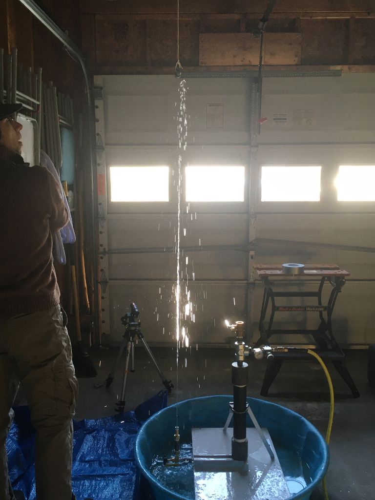

Recently, for my PhD I did some tests on the height of jets of water, a glycerin-water mixture, and an isopropyl-alcohol-water mixture. Testing vertical jets is much simpler than measuring range. I have a height marker that I move down until it matches the height of the jet. See the attached photo. I can do these experiments much faster than a range experiment. The pressure can't go above about 20 psi because the tests need to be done indoors and the garage I'm using doesn't have a very high ceiling, but I'm sure I'll find a better facility in the future. If you're aware of any indoor places that can get a little wet (most water is caught by the pool) with a ceiling over 10 feet, let me know here.
The results were not entirely as expected. Some of the earlier tests showed the jets shooting higher than I thought was physically possible, so I made a few hypotheses about the cause, eventually narrowing it down to an effect that I was aware of but hadn't really fully internalized. Additional experiments confirmed my hypothesis. I was able to get one jet to shoot 50% higher than I thought was physically possible before, in fact. Not sure how to take advantage of this in water guns just yet, but it's something I'll be thinking about. I don't want to go into detail now. I'll post after I finish the paper on these experiments, to be published at the ILASS-Americas 2020 conference.
Anyway, all in all I am looking forward to 2020.
- lowering-the-marker.jpg (230.54 KiB) Viewed 22928 times
