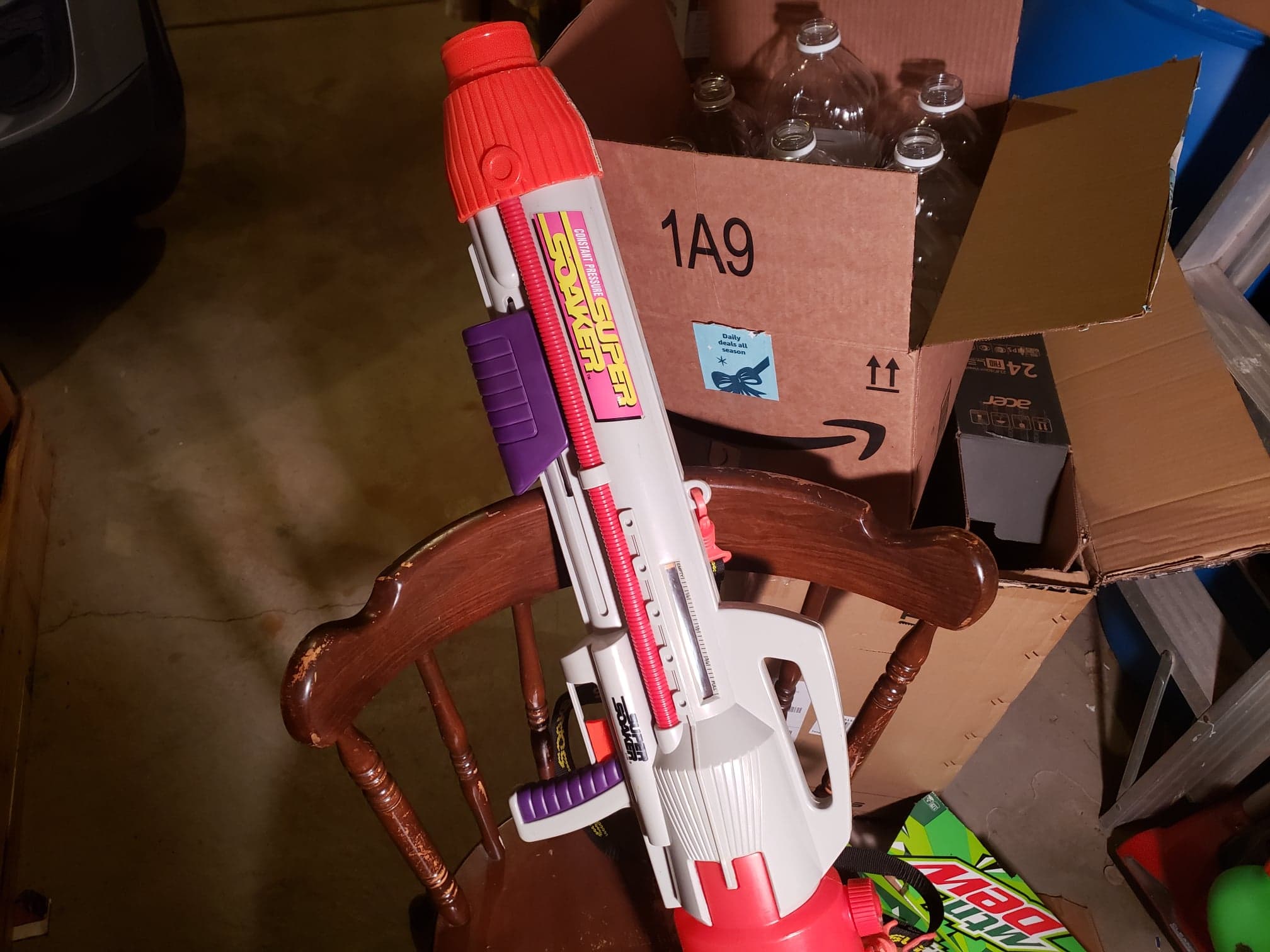

Greetings, I am Sozo and I'm hoping to get some help with a blaster I just acquired. Anyway, I recently acquired a cps 2500 on ebay for a steal and was elated to get it.

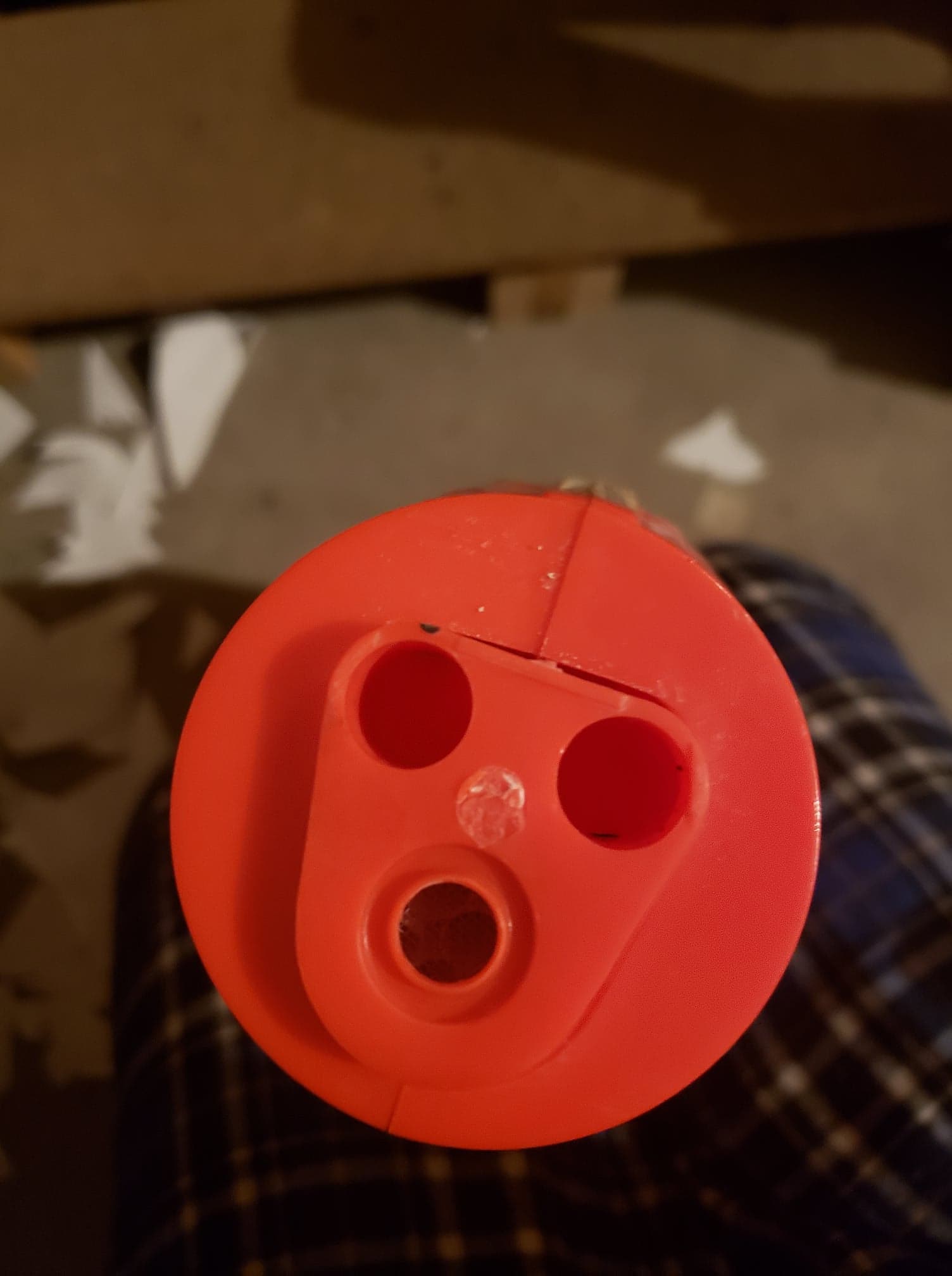

So, it does pressurise and shoot, the problem is that when I did pull the trigger, the nozzle selector flew clean off. It broke right where the screw had connects to the nozzle. Other than that, the gun seems to work fine. I'll be getting pictures for you guys soon.
Thanks guys. I really want to get it back up and running.

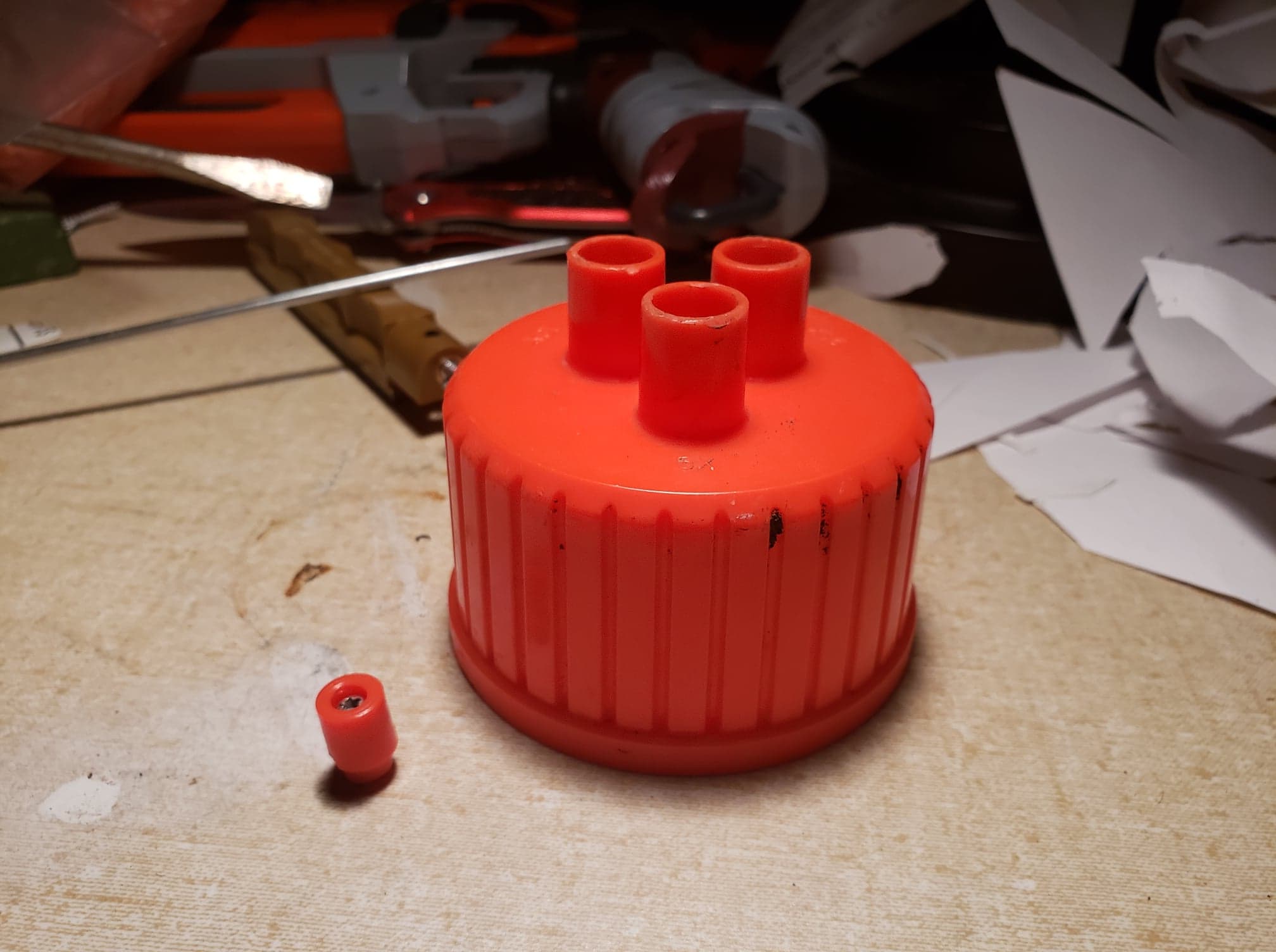

Repairing this will require a fair amount of work but is possible. Personally, I would find a broken CPS 2500 and swap out the entire front part of the valve with the flow straighteners. That would be the easiest repair. Without that, I would simply attach a PVC threaded adapter to use screw-on nozzles.
If you're set on repairing it back to the original functionality without a broken CPS 2500 to cannibalize, here are some things to consider:
There should be two of the orange bumpers. See the image below. Did you lose the other one when it broke? This part is probably necessary to make sure that the nozzle selector seals properly.
I also assume that there was an O-ring in the slot around the water opening. You should be able to find a replacement in a hardware store, or, failing that, online.
Once you have all the components, the main task is going to be basically attaching the nozzle selector to the blaster. You'll have to make a new "nub" for the screw to attach to. It might be easier to not use the existing screw and substitute your own. This might require drilling a larger hole for the new screw to go through.
It would be better to attach the new nub at multiple places with small screws than to try an adhesive. Something like this might work because it has three prongs: https://www.mcmaster.com/94122a100
But it might not be possible to use screws to attach the nub if the inside of the front end of the blaster needs to be sealed. I think it's probably okay to screw through the top part between the two openings but I'm not sure on the other sides. Might be safer to instead pick a surface-mount nut with only one attachment point and use the spot between the two openings at the top.
McMaster-Carr has a wide variety of surface-mount nuts available that you could look through to see if any fit the dimensions: https://www.mcmaster.com/surface-mount-nuts
You'll probably have to try a few things before figuring out something that works. Anyway, I don't mean to discourage you as this should be repairable but it's going to take some machining skills and patience.

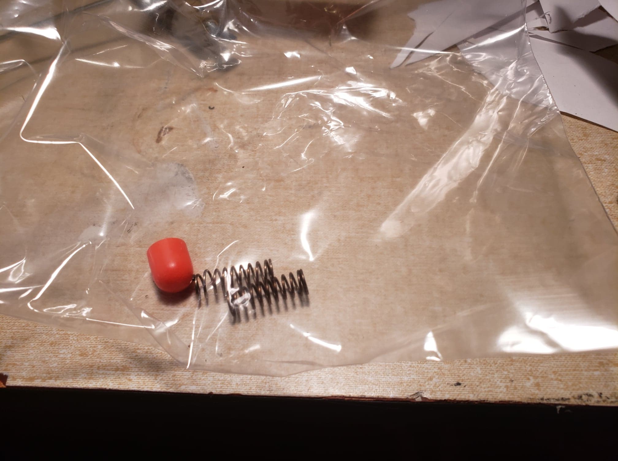

- "I still have the springs as well."
- 4.jpg (181.74 KiB) Viewed 12832 times
- "Apologies for the clutter, its my sharpening area/nerf gun storage place. Here is the nozzles and the part that busted."
- 3.jpg (152.59 KiB) Viewed 12832 times
- "See that break? Yeah, i wasn't too happy when i saw that, but at least its a clean break"
- 2.jpg (94 KiB) Viewed 12832 times

You will have to open the CPS 2500 first, but that part is fairly easy. Put the nozzle selector to the side. Put the old screw and plastic bit to the side.
Drill a hole through the center of the broken part. Put a long and skinny machine bolt with a fender washer through the back of the nozzle selector.
Remember that plastic bit? Drill a hole through it big enough for the bolt to go through easily, and cut it to just the right thickness, making sure the selector will rotate smoothly on it. It should sit flush with the plastic from the nozzle selector. If you can't, you will need a vinyl washer or spacer cut down to the right size.
Screw a nut onto the bolt for now so it doesn't fall through, and reassemble the 2500. Remove the nut.
The nozzle selector has a fairly large hole in it, and you will need a slightly larger washer (but not too wide) to go in the center of the three nozzle settings.
Now put the nozzle selector on the machine bolt and add the washer, lock washer, and finally a nut. The lock nut should keep it from ever unscrewing but will allow you to rotate the nozzle selector no problem.
The hardest part for you may be finding the right nuts and bolts, but they are commonly available. Good luck!
