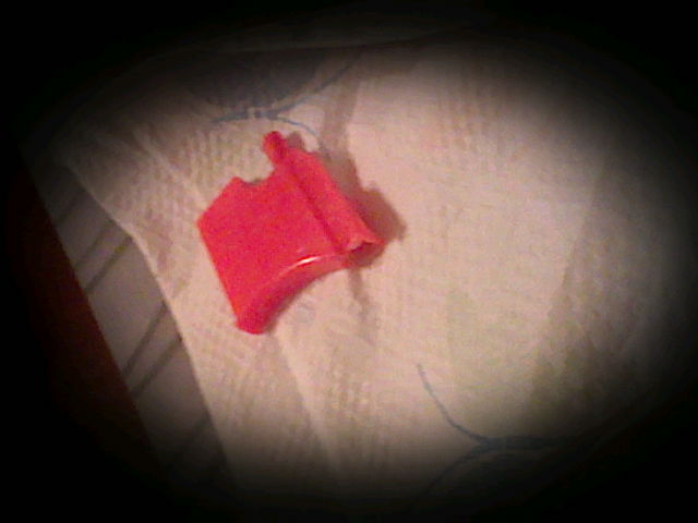

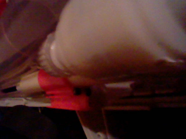

Faulty CPS2500 trigger Repair 004.JPG (39.25 KiB) Viewed 5805 times
Faulty CPS2500 trigger Repair 002.JPG (33.57 KiB) Viewed 5805 times
Faulty CPS2500 trigger Repair 001.JPG (39.37 KiB) Viewed 5805 times
Poseidon2000
Posts: 600
Location: NYC
Re: Is This The End??? Probably Not.
Post by Poseidon2000 » Wed Oct 10, 2012 2:04 pm
So, ^^^ That's the problem. Next is just internal areas.

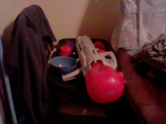

The Opened Beast
The Opened Beast
Faulty CPS2500 trigger Repair 021.JPG (47.13 KiB) Viewed 5805 times

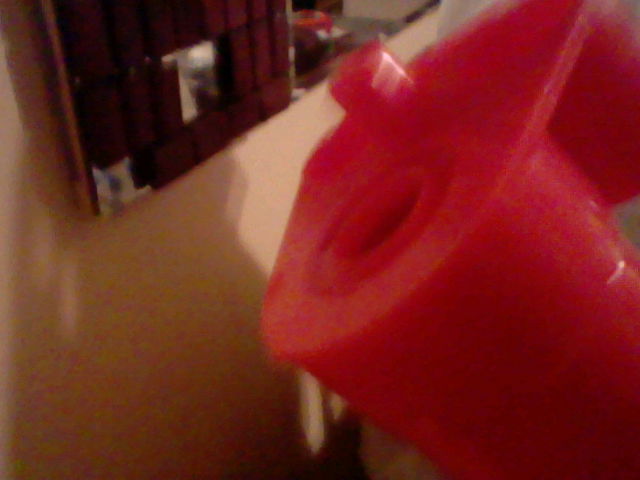

Nozzle (O-ring removed, I still have it, Don't worry! :p)
Faulty CPS2500 trigger Repair 018.JPG (43.5 KiB) Viewed 5805 times

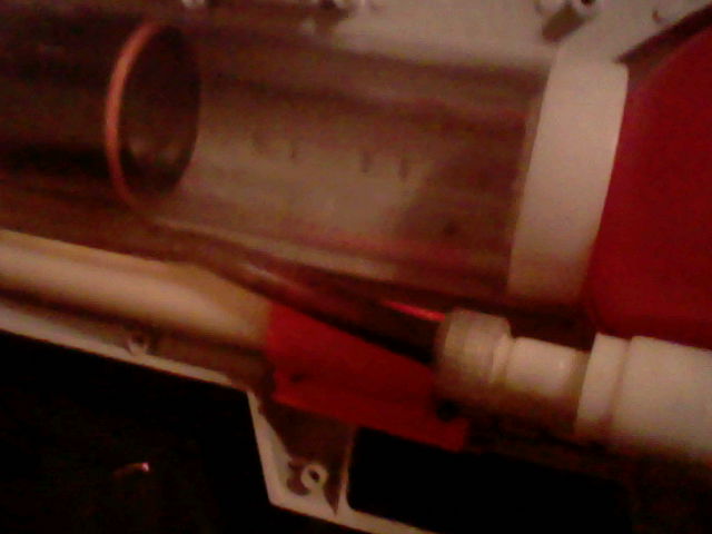

Intake
Intake
Faulty CPS2500 trigger Repair 007.JPG (41.17 KiB) Viewed 5805 times

Now, the overview.
Okay, I glued the trigger part's cracked and crushed areas to regular(pic of trigger on tissue), and Tonight I will glue it on the internal area. Friday(~48 hours), I will epoxy. Sunday, Testin' and final tweaks, and close up, Lock and load! :cool:
