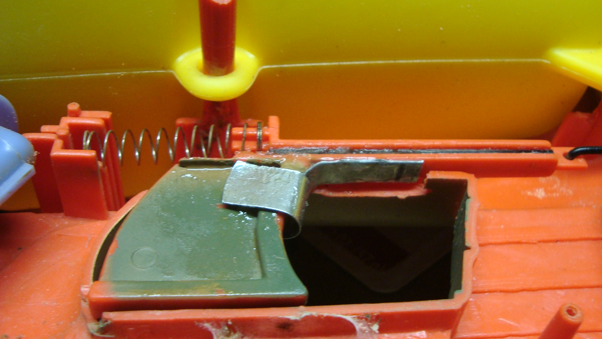

Post by SEAL » Fri Jun 24, 2016 5:31 pm
Good stuff. Here's how I did my 2700 trigger:
This was the third attempt, and despite being ugly, so far it's held quite well (I only pull on the metal part to be sure), however it seems I didn't file the casing down enough because it sometimes catches and gets stuck open. This played a big part in my team's loss in the CTF round at the last Frozen Fury.
I think this is the area where 3D printing will help the most. I will make that a project this fall.
