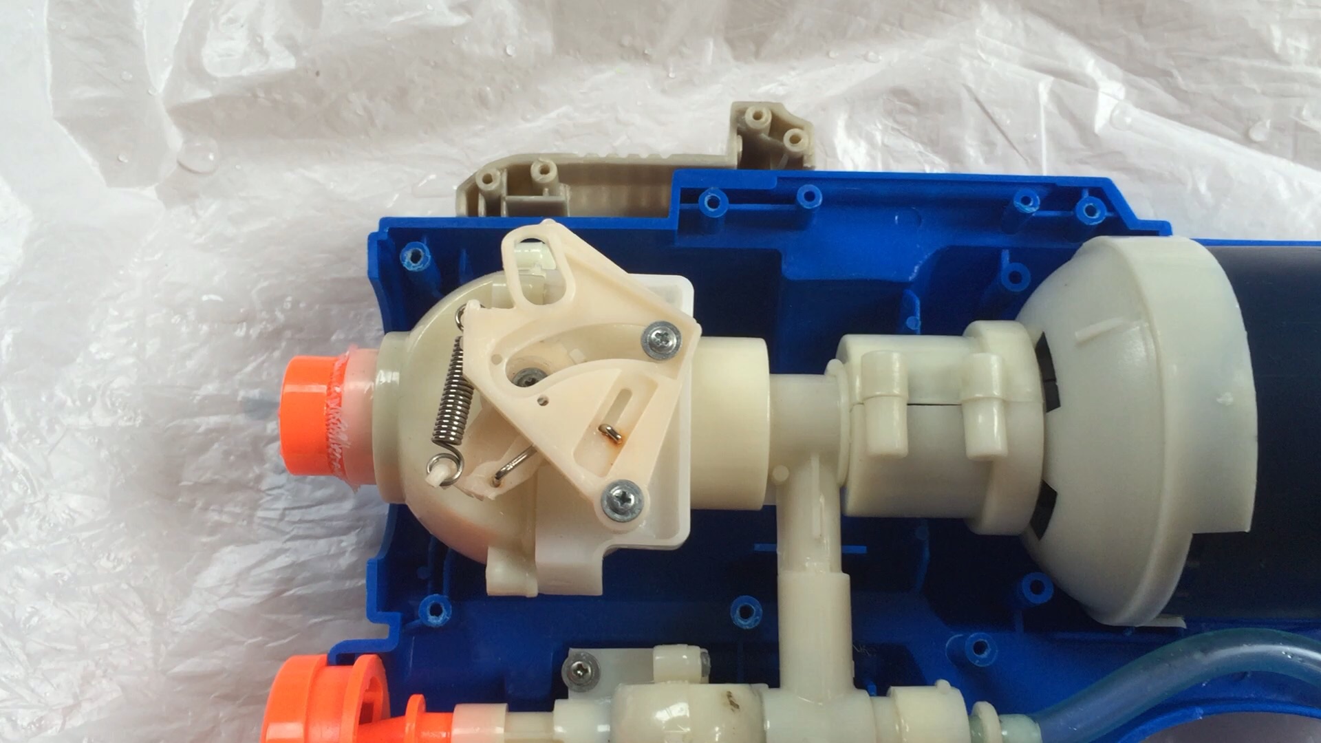

Also try lubricating it with some silicone lubricant. I noticed in your picture that you have pulled the lever back all the way.

I opened it and lubricated with silicone lube spray. It seems the valve is working properly. I will reassemble it and do test fire later on. If anyone comes up with anything else I can do, please let me know. Thank you.

If you didn't disassemble the Max-D mechanism and rotate the valve around its entire range of motion to check if its moving more easily (as well as for spreading the grease around), then the job wasn't done right or perhaps you didn't use good grease. You do not want to use aerosol based silicone grease; the propellent is partially diluted in the grease and it will damage the plastic; not worth the risk except as a last resort.
Make sure the valve moves around freely before reassembling it.
After that, you may want to add rubber bands to assist with the valve closing, but the spring alone should be able to do the job.

I didn't disassemble the Max D mechanism, so I will try. And I didn't know the aerosol silicone grease damages the plastic. I will also have to get some good grease. Thank you always.
