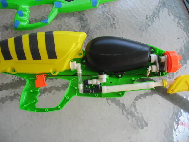

I am posting this as a possible help with repair thread/to question the reliability of the water warriors colossus. I bought the Colossus last spring, so I have had it a little more then a year at this point. During that time I have had a few battles with it and have kept it indoors the rest of the time. It was very surprising that after only a year a few plastic parts have snapped and the internals were badly rusted (even my Vindicator wasn't this bad, and it was kept outdoors for three years!) Has anyone else had reliability problems with the Colossus or did I just get a bad model?
I have included pictures of the various problems:
Overall view of blaster open. You can't really see to much from this one, but notice how rusted the trigger rod is. Even my Vindicator isn't this bad and it's gone through h***! Should a year old gun that has mostly been kept indoors be this rusted?

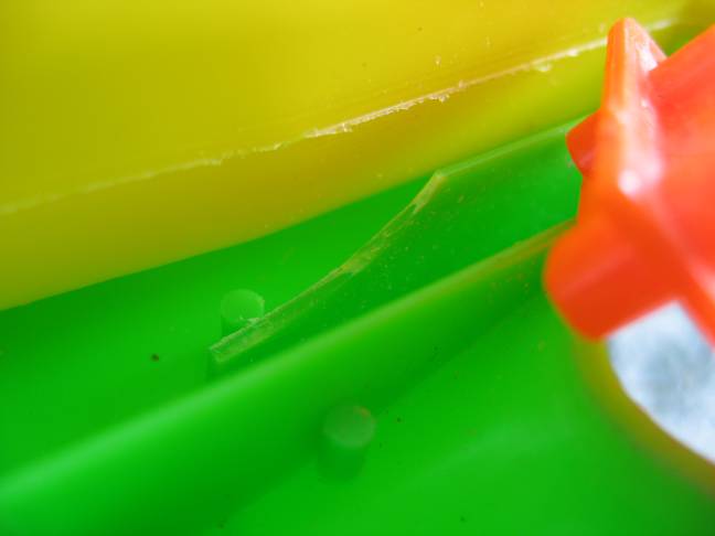

Here you can see how the plastic guide for the trigger mechanism snapped. Without the other end of the groove the trigger must be pulled really far back in order to fire at all. I plan on gluing a piece of metal to the remaining part to remake the rest of the groove.

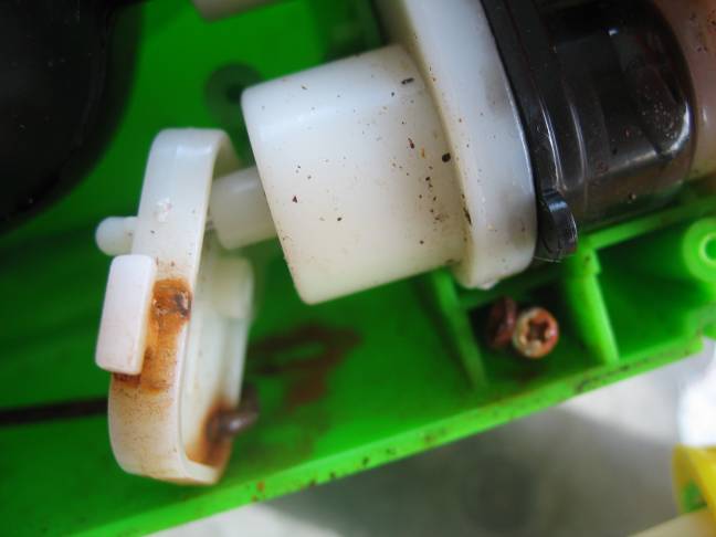

This spring got rusted so bad that it broke. I'm not sure if this happened as I opened it or before that. Ether way the gun still seems to hold pressure without it (air at least). Another thing to note is the fact that the Colossus uses a pull valve where all the other water warriors guns I have taken apart used ball valves.
The other thing that happened is that when opening the gun the plastic that the pump cap attaches to broke and came off with the cap. The plastic on the Colossus seams very brittle compared to other Water Warriors guns as I was pulling it very lightly when it broke.
