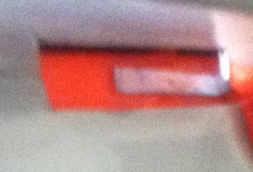

Post by fuzeEXR » Tue Jun 25, 2013 3:04 pm
Here's a pic of the underneath side of the trigger I just did. Hard to see in the picture I didn't take it until I put the gun back together.
