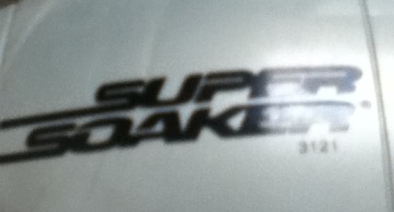

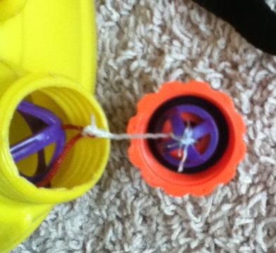

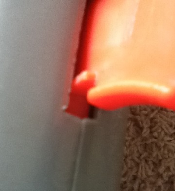

Some pictures of the gun and what some of the mk indicators are, maybe you can help me know which one this is.
- inside cap
- 064.jpg (46.44 KiB) Viewed 8271 times
- logo and mumber
- 063.jpg (13.44 KiB) Viewed 8271 times
- Gun
- 062.000.jpg (49.91 KiB) Viewed 8271 times

That 4100 looks like a Mark 1 to me, the purple reservoir cap tether and seam on the back of the reservoir give it away. Mark 2's have large rectangular ridges down the rear of the reservoir and an orange reservoir cap tether. Chances are the trigger should be fine, although reinforcement is always a plus if you want to be really sure.
