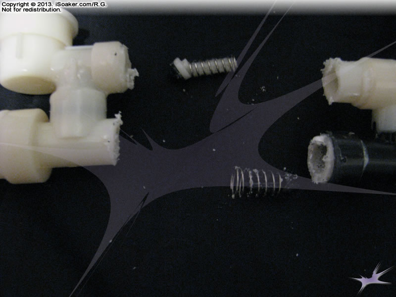

As for cutting them open, no need. I just did and there be springs inside.

Sometimes, a water blaster needs to be sacrificed in the name of research.
The following is a hacked open Water Warriors Colossus valve assembly. (the file name says Python 'cos I mislabeled it.
The right side is where the reservoir would be and the white area on the top-left is where the pressure chamber attaches to. I also was reminded that there are actually two check valves and the pressure relief valve in this assembly. I keep forgetting about the 2nd one after the pump (vertical and unhacked on the left-side of this image).
Since I used a coping saw to rip into these valves, I damaged the upper pressure relief valve's plunger. However, now that I've seen the inside of these valves, it makes it a lot easier to try to illustrate them and how they work.
Edit: for those who didn't notice, the spring for the pressure relief valve (top) is much more uniform and offers more resistance than the spring used for the check valve (bottom). For all intents and purposes, a pressure relief valve is just a check valve with a pressure-rated spring.
