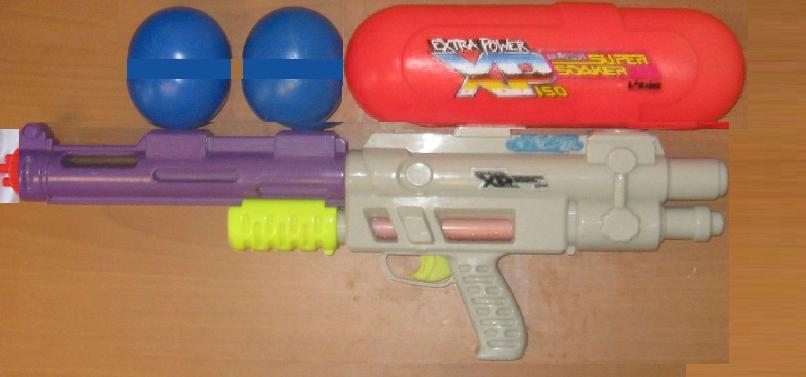

Yeah I ripped off the XP 150, But I re-sized it to give us what we wanted
WW Swordfish
Range 42'
Nozzles 3x, 5x, 10x, XP shower nozzle (It's got a larger spread than quad burst)
Capacity 100oz (I did the math I think that should be right)
PC volume 25oz pressurized
Pump volume 2oz per stroke
Dimensions should fit as well,

The original XP150 held ~500mL (16.7oz) pressurized and 1500mL (50oz) in its reservoir at a size that is almost already at the max. dimensions specified. Trying to increase the PC by 50% and the reservoir by 100% is not possible to fit even if the overall size were increased from original (22.8"x3.5"x11.8") to recommended max. size for this thread (25"x4.5"x12.5").the oncoming storm wrote:Yeah I ripped off the XP 150, But I re-sized it to give us what we wanted
